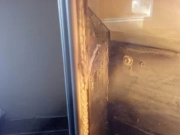

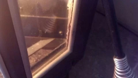

Stove did pretty well for 2 days. Had to shut down and empty the burnpot. Something interesting I have found...
Along the windows there are a few areas where there seems to be some soot buildup.
Is this maybe a source of an air leak?
Not sure about the soot, can't really see it but what happened to the faux brick fireboard....did it break? From what I can see your ash looks ok....
