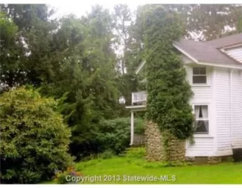

I don't know the exact number of feet yet, but 2 good size stories.
It's hard to see in the picture because the ivy is covering it but it rises above the peak.

That will need a stainless steel liner for sure but the 2 stories height will help draft once it gets pulling.

if you could set it into the floor that should work also. Get a pro or 2 out to look at it if they are any good they will give you a few options. And like begreen said it should be insulated. Also get that damn ivy off that chimney it will tear it to pieces as a chimney pro i cant stand to see that because i know how much work it takes to fix the damage.
