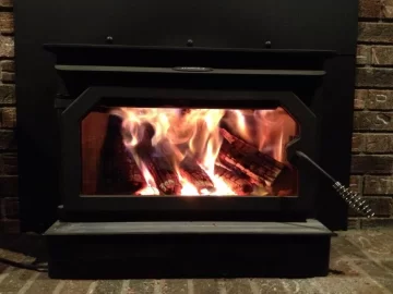

Pic below!
[Hearth.com] Experiences with Lennox?
Deerhunter - Thanks for the response! I pulled the trigger on the Canyon as well, and had it installed last weekend. Haven't really put it to the test yet, as I still need a hearth extension and an outlet box installed to run the blower. I'll be tackling the electrical this weekend, and should have my hearth extension the following.
My house is considerably more open than yours and a little smaller, so I suspect I won't have near the challenges in moving heat around as you do. If the Canyon is meeting your needs with more square footage and segmented rooms, it should keep me exceptionally warm. I can't wait to put it through it's paces next season.
I went with an 8" liner as recommended for my chimney height (I only have 13-14 feet). After install was complete, we lit a small test fire and it seemed to draft well. Hopefully, the same will be true when it's 5 degrees out with 40 MPH winds!
I'll try to post up a few more pictures of my install over the weekend. Overall, I'm very happy with the look and quality of construction of the unit. Hopefully, the performance measures up as well.
