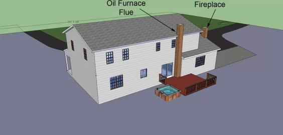

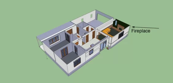

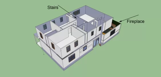

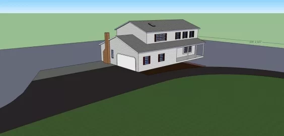

    Hi ladies and gents,
    I've been lurking here for quite some time, and have been learning a lot about stoves. I have an open masonry fireplace on the first floor of a 2600 ft^2 colonial-style house in Upstate NY (and a $3500 oil bill!!). I love to burn wood, but it is obviously a waste to burn in the fireplace. I've got my mind set on purchasing an insert, but I wanted to get a reality check from the experts here based on my floor plan as to what type of reduction I can expect in my heating bill. Just so you know, I've been stockpiling wood and have about 3 full cord of 2+ year red oak c/s/s (and scrounging more as we speak ==c). I've included pics of my floorplan, and you can see where the exterior fireplace chimney is. Existing dimensions for fireplace box is 36" w (face), 30" w (back), 26" h, 23" d (bottom), 19" d (top).
    Right now I'm down to the Lopi Freedom, Country Canyon C310, and PE Summit (and still kicking around the VC Merrimack).
    I've got thick skin...

    Welcome, Deerhunter, to the forums............ man, have you been paying attention :)
    The left side of the first floor, how open are those doorways? I'm assuming they are bedrooms/offices?

    Thanks Dixie! Yes, a centrally-located free-stander would be the preference, but my DW refuses since we have 4 children (7,5,3,1). I told her they would only touch it once :oops: The only thing she hates more than fire is spending money, so we compromised on the insert with a wrap-around barrier.
    We almost always keep all 1st floor doors open.
    Oh, and there are no interior sliding glass doors - the first floor (family room - breakfast area - kitchen) is all open.

    First, that is the best house diagram I have ever seen on this forum. Second, I think it is worth putting in the insert. You will not replace the oil heat, but I bet you can save the cost of the insert in reduced oil bills the first year. I have a small wood stove in a rather poor location in the house and I save a few hundred a month on my electric heat bill. Your bill is far higher than mine so I think you'll save more.

    I would put a 3 cu ft insert in, but the main problem is going to be heat circulation. That is what I call a house of doors. It's going to take having all those glass doors open and a fan set correctly to encourage heat circulation. You will get better results blowing the cold air toward the warm. Try putting a fan in the dining (?) room doorway, blowing across the kitchen toward the LR. If all the doors are open, it should pull the air though the family room, into the dining room and then toward the living room.
