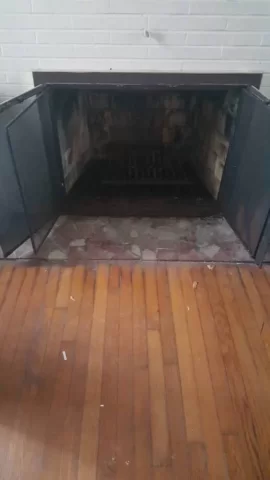

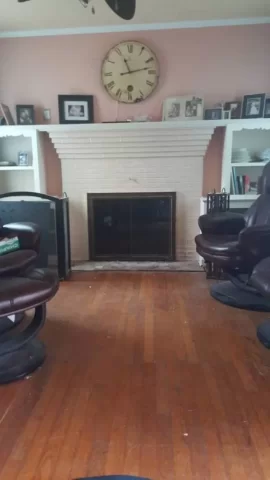

My house is 1940's, but brick fireplace added somewhere 70's or 80's. I just had inspected and am told no liner, so having a stainless triple liner installed with a small wood stove. I'm trying to figure out how to add a a new hearth level with the fireplace so the stove can be partially inside to vent.

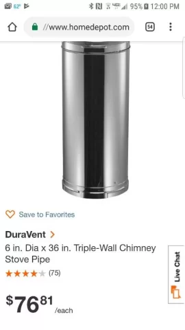

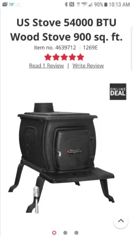

There are other low cost stoves that are much better then that stove. Also that is chimney pipe not liner. If you want to use pipe then use double wall class a, its better then triple.
I would SERIOUSLY take a step back and do some research. You are headed in all the wrong directions. IMHOFWIW

I'm not sure what you mean? I had a chimney guy from a very reputable service of 35 years, inspect it, give me a quote of $800 to supply the pipe and install my stove. He even thought this little stove was best for me since I can't afford more, need a very simple stove and can only have a stove no higher than 27". I know I'm in over my head, but I have a tree coming down this month, so was thinking ahead. I got pushed into retirement, so no extra money. Now I have to figure out a hearth that I can do myself using marble tile in my garage. Wish me luck.

Installing a stove is not based on luck. Safety has to be the overriding concern. As far as the hearth goes, this stove needs R= 2.06 protection. Laying down marble is not going to come close to providing the heat protection for the floor that the stove needs. The insulated hearth pad will raise the stove height, potentially a couple inches.
The chimney pipe you show is not necessary or normally used in a masonry chimney. Your installer will need to install an insulated flexible liner instead with a properly sealed top cap.
The stove may fit the budget, but it is not known for quality construction. The castings are cheap and poorly fitted. These weaknesses combine to make a stove that can be difficult to control and with a tendency to overfire easily. This stove is from China. It has a history of arriving with parts missing or cracked. Inspect carefully before operating.

If he is recomending that stove and that pipe 35 years of working in this feild has not taught him much. You need an insulated liner in your chimney not anither chimney inside it. And that stove is in my opinion the absolute wost stove on the market. It is a copy of a design that is close to 100 years old and it was copied very poorly. The castings are extremely poor quality and because of that the fit between panels is very poor. This leads to leaks which makes it uncontrollable. That overheats the bad castings leading to cracks. It is a dangerous stove and i can beleive they are still allowed to sell it.

Thanks. I do understand. I just chose a picture, but I've asked for a detailed quote from my licensed chimney sweep who is installing. I realize this stove is cheap, but I don't intend to do more than take the chill off of this room and have in case of power lose.

I understand you dont intend to use it much. But you could not pay me enough to start even one fire in one of those stoves in my house. They really are very bad.

Practical, why not Englander? They make some much better quality options, with many good reviews, at low budget prices. Begreen and bholler will have to advise on the hearth R-value requirements, but Englander is the first brand I would consider if on a budget.
