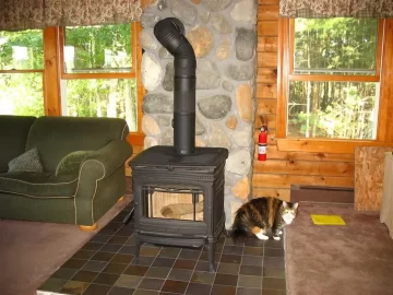

Have had no problem with the stone I put up - this is a pic before we put up some wood beams on the end. We have a air gap of about a inch or so between original wall and then concrete board which is on strips of that same concrete board to make the air gap. The stone was put up then with a masonry mix and no problems first year of burning. When I had a new chimney put in we knocked off some of the stone and put it back up with some adhesive - it was just stuff that we put in a chalking gun. Much easier then the masonry mix and no problems as of this season.
I probably can find more pics of the actual construction of the wall if you need - just let me know

My cultured stone has been there for around 25 years and they are mortared in place and still look fine..

HB I think the cultured stone looks as real as the real thing aside from it being much lighter nobody knows it isn't real..
