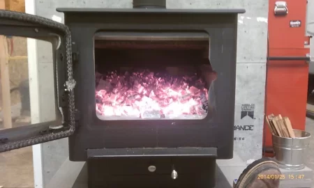

So 3800 SF, 1972 build, an insert, in a basement, 2.5CF (small/medium), in Idaho at -20. It's not your wood, your stove is not big enough at all. You are running into what happens when you try to get more heat from a stove than it was designed to produce. In order to keep your house warm you need that stove running at full blast all the time and doing that will cause coal buildup.
It may also be your wood but even if you had awesome wood, you'll have this problem. You need one of those stoves on each level of your home to have a chance and even that isn't really adequate. 2.5 CF in an insert is just not much HP.
I attached a picture of what happens when I try to get max output from my much larger non-cat. It coals up. Those first few stages of the fire make much more heat than the coaling stage which is a long stage. People have even gone so far as to shovel out those coals to get fresh wood in the box and make more heat.
And yes, one full summer cut, split, and stacked in the sun and wind is enough to dry most of our PNW species. Longer is better and for crying out loud, cover your wood in the fall before the rain/snow.
Fedex 'em to me, my cat will heat my house all day on that load. That is a cool picture; I have never seen so many coals in a stove!
