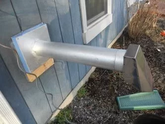

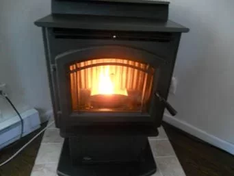

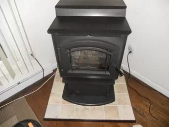

Okay, I promised myself I would post pics after the install, so after 3 and a half months of delaying it, here they are.
Impressions:
1) ICC excel pipe is awesome. Easy to work with the gaskets and the actually work. Haven't smelled any smoke at any point. I just made sure to silicone the gap between the two adapter pipes. But that was it.
2) Before I had the duravent thimble with the OAK which managed to suck in some soot, as I saw in the OAK hose. So I made a separate hole on the adjacent wall and used a vent with a built in screen. Works really good.
3) The ability to detach the ICC pipes and reconnect with the gaskets will make maintenance much easier if ever I have to move the stove to replace parts, and not worry about smoke after putting it all back together. Happy about that.
4) Lastly, and stupidly, I build the hearth pad in the basement. Plywood, cement board and tumbled stone make a very, very heavy object when put together as one. It was a PITA getting it upstairs without damaging it, me, or the house!!!!!!!!

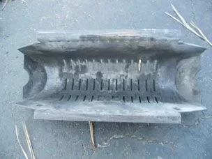

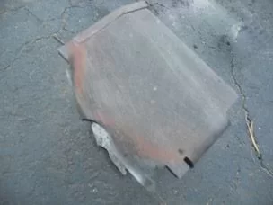

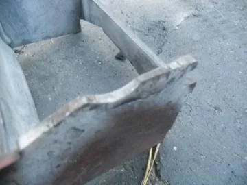

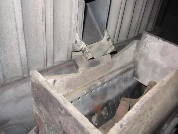

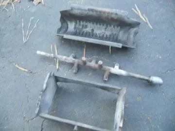

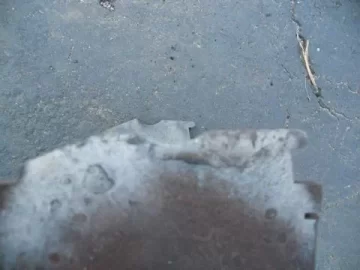

Also, I have been noticing the slow corrosion on one side of my fire grate, which wraps around the burn pot and burn pot liner.
It happens on the right side, so i figure it must be the fresh air, which comes out on that side, doing some type of reaction to the metal. Moisture maybe. Not sure. But here are some pics.
For two years of burning, everything else looks pretty good, especially the fire pot liner and the agitator rod.

My burnpot grate is corroding too. Also my agitator shaft is thinning. Heat and the corrosives on the ash are working on them. A fellow I know has an M55 steel and he only burns his on 2 heat setting. He has had his about a year less than me. But his looks new. I am guessing the hotter you burn the worse it gets.

Install looks nice. Much neater looking without all that goo on the pipes. ;-)
Thanks, J. It does look better, even though I had to patch my T1-11 siding to cover a gap in thimble sizes (I am a rookie carpenter).
As for running the stove, we run it on all settings, but in the middle of winter, mostly 3, 4 and occasionally 5. Weird though, how one side is affected and the other is not.
M55 seems to burn hotter on one side compared to my Omega. Do you see more flame on the side that has the most corrosion? The flame seems to favor the left side in your picture.
it does burn hotter on the left side. i can even see the larger flame on the left side. but the corrosion is on the right side. it has to be a combination of heat, pellet chemicals reacting to the fresh oxygen from the OAK.

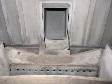

I made a diverter and now my flame is much more even across the pot. It was very easy, cheap and removable and no drilling or mods to the stove. Makes watching the flame a lot more enjoyable. The stove drops more pellets to the left side of the burn pot which is why you see more fire on that side.

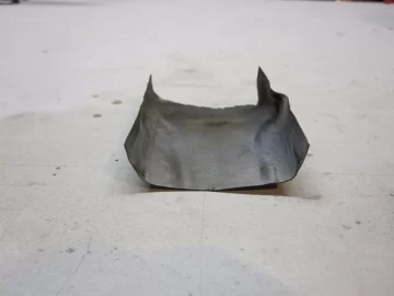

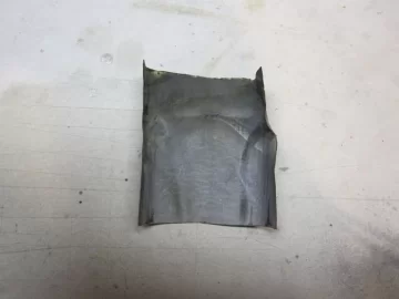

Here is the simple and cheap diverter I made. It is cut out of a 26 gauge sheet I got from HD. Cut it in a square and then bend it in the shape of the drop chute. I then bend the left side vertical to deflect some of the pellets to the right. That is all that is needed. You can adjust the amount of deflection to get the fire much more even. If you go too far it will kick some pellets out of the burn pot. Works great. To keep it from sliding down, I open up the "U" shape that goes behind the liner. You can then bend it to get it to slide in behind the liner, but it will spring back out enough so that it won't fall down. It may look a little rough, but it works so I haven't tried making a new one a little nicer. Besides you can barely see it when the stove is running anyways.

Flynfrfun, I have a consistent problem with carbon/scale buildup right in the center of the pot on the tab in front of the ignitor.
I notice pellets pile up here with no air holes to feed the fire and the pellets smolder until stirred.
Did you ever notice or have any buildup here, and did this help.
I do notice more carbon buildup in that spot, but only just a little. Nothing to worry about.
Carbon has a lot to do with the pellets your burning. I get little to none with softies and much more with some hardwoods. Seeing as flyn is burning one of the cleanest burning(doug fir) pellets. They'd spoil us New Englanders! ;-)
Wachusett, I burnt 30 bags of GT's and had lots of carbon by the igniter hole and also on the back side of the liner. I haven't burned any softies this season but last year burned 25 bags of okies and 4 bags of spruce pointes. Had jsut a tick of carbon by the igniter hole. None on the back of the liner. I also burned 20 plus bags of Turmans and had just a bit of carbon by the igniter hole. None on the back of the liner. When I switched to Stove chow I got the most carbon build up of any pellet I burnt. If I didn't scrape the pot once a week it sounded like a beach whale moaning. Surprisingly the grass pellets had no carbon scale at all, But loads of silicon like sand. With little stones about the size of a raisin.
Do you get the same amount from the GT's as the Barefoots? I haven't burned Barefoots in a few seasons. I can't afford their prices, So I bought Hamers and Cubex instead. I'll let you know what the Cubex does, I'll be burning them this week. Time for the cold weather stuff. ;-)
J-
I get carbon buildup even with the Doug Fir. Maybe 1/16" in certain spots in the bottom of the burn pot liner. That's after 1wk of burning. It seems to vary from brand to brand. Don't think I've heard the whale call sound yet though. It would take a lot of carbon for that to happen.
flyn, I am talking 1/2 inch of build up from the hardwoods. Makes a heck of a racket. Broke one of the agitator ears off last season. I had to get it welded back on. Mine isn't the cast agitator, Its a welded unit the early stoves had.
