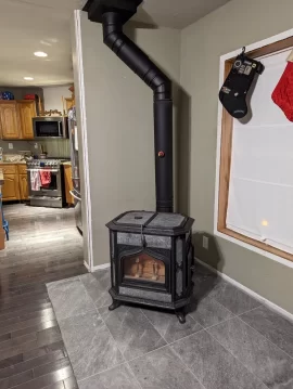

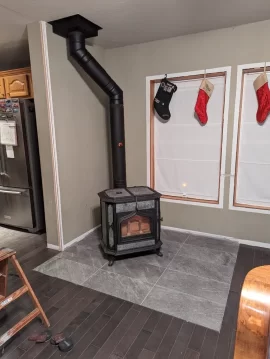

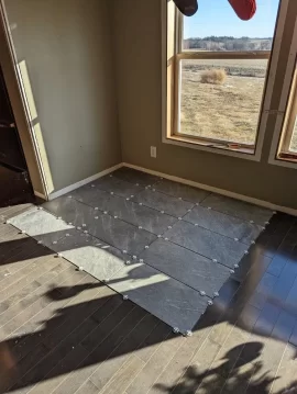

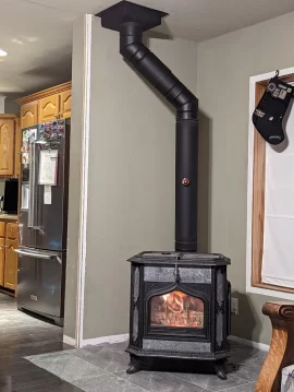

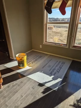

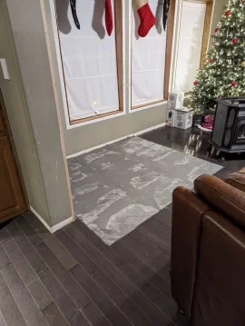

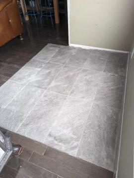

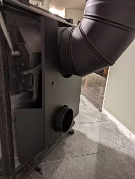

I have been carrying wood down the basement stairs heating our house from there for the last 10 years. So about two years ago, we decided to move our unused Fireview upstairs to our living room. Well, things change, plans get delayed, you name it, but it finally happened. We married the last kid off this summer and decided we didn't need to heat the basement anymore, so I finally got around to installing the Fireview upstairs over the last couple of weeks. In the process, I did a minor rebuild on the stove and put in a hearth pad. With the corner install and finally being above grade, I went ahead and installed the rear heatshield and the adapter for an outside air feed. I also replaced the cast iron scoop with the new stainless version (I really like the finer mesh screen on it.) My old ceramic cat was showing its age, so I replaced it with a new metal one from Woodstock. It had its first little fire yesterday late afternoon than last night, we put her to good use. Temps are crashing here over the next couple of days, and I am happy to have this stove working again. I will put some pics of the hearth build, the heatshield, and the installed stove here, then in the next post, I will add some obligatory first fire pics.

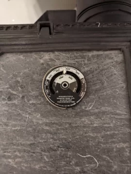

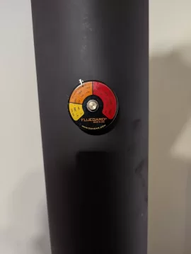

Here are some pics of the first fire and my standard settings for running this stove. The picture of the chimney temp is just after I closed the bypass, the temp fell steadily down to about 375-400 afterward. The stove top temp is about 40 minutes into this load and peaked at about 525-550. I really have missed this stove, even though I love the BK Princess that we have been using in the basement.

Very nice job, and good color scheme! 👍

That flue temp appears a bit high...must have been either toward the beginning of a load, or trying to crank out higher heat. The Fireview definitely has another gear over the Keystone, as far as heat output.

The flue temp was unusually high for this stove. It was right at its peak and headed down on a hot reload. This was during our -14 degree cold snap, and I was pushing her a bit. The wood caught fast, and I was a bit slow, bringing the air down. It did come back down quickly after my brain caught up with the stove, and I adjusted the airflow correctly. I have not burned the Fireview for three years, as the Princess in the basement has been my go-to for heating the whole house from there. I am relearning this stove and enjoying how simple it is to use/burn.
We are enjoying having it upstairs, especially the view. It puts out nice even heat and is just such a nice looking piece of furniture during the off-season.

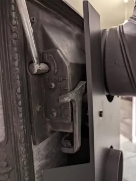

Finally had time and a warmer stretch a couple of weeks ago to do the rest of the gaskets and reseal the seams in the firebox. I will attach a couple of pictures that show how it came out. For what it is worth, with the glass removed doing the seams was an easy task (not sure if taking the rest of the guts out would have made it any easier.) We went on a trip to babysit our grandson while his mom and dad were at the hospital bringing our newest grandson into the world so the stove sat for almost 2 weeks after all the work. I replaced the glass retainer and andirons that hold it in place as mine were showing their age. The new glass retainer is not a cast piece it is heavy steel as are the new andirons. We shall see how they hold up. I like the look of the new andirons you can see them in my next post.

Here are a couple of pictures of it running now. I am very happy with the control I have regained over the fire. I must have been leaking more air than I thought through the sides of the stove. You can see the new andirons in these pictures. The stove is behaving wonderfully with the ability to extend burn times and has more control over the burn and to run lower/slower burns too.

Good work! 👍 Probably a little better access with the guts pulled out, but looks like you were able to get to the seams well. Shoot, I didn't even have the glass out when I did SIL2's...pretty cramped working through the little load door. 😣
What was wrong with the old andirons? I wouldn't think that they could get damaged..? The new ones do look cool, though! :cool:
I generally have the stovetop meters over the cats on the Ks and Fv, about midway front to back along the center rail in the case of the Fv, since that's the hottest area of the top..
I probably could have gotten by not replacing them. The old glass retainer was warped a bit, and it made them tilt toward each other. I wasn't sure if they were actually straight or if they had a bit of a warp. They were almost welded onto the glass retainer. I also like how the new ones look.
I have been moving it around trying to see if the plate directly above the cat on the lid causes the temp to be slower to rise in the center. So during start-ups, I have been putting it there but during the main burn, it is back where you described. (As a side note, I see a higher max burn temp in the center than towards the back by nearly 100 degrees.)
