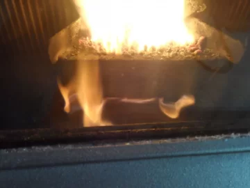

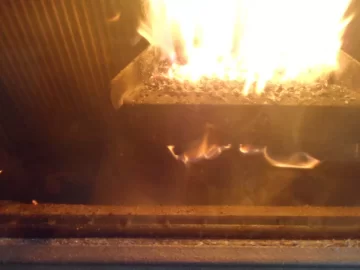

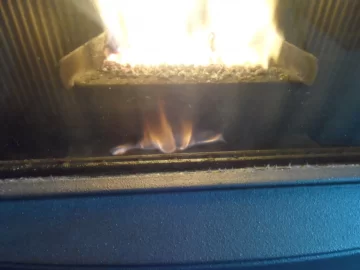

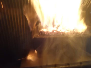

Here are some pics I took of the flames outside the burn pot after the New burn pot had been installed...
Do they look like flames curling around the flame guide to anyone?
1st Picture I am trying to show the flame that burns out side of the burn pot on the side and pics next 3 pics show the flame coming from under/beneath the burn pot...

View attachment 155795 View attachment 155796 View attachment 155797 View attachment 155798
If you have an email address for Harman send those pictures to them and copy the dealer. Meanwhile back off the feed A LOT or better yet quit burning the stove until it is fixed. If Harman has a facebook page post those pictures there if possible and ask what gives?

Smokey I have the feed down to 1 1/2 ... if you look at the pictures blown up you could see better the ash line & burning is back farther . Certainly no pellets being pushed over the burn pots edge...

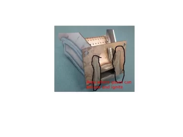

Here's my inductive reasoning: I hope it helps.
I'm just curious, did you inspect the back of the back of the plate on the old one for staining around the hole and square areas? The area around the hole where the gas is escaping will discolor the steel a little bit since it interacting with the gases. The fire in the burn pot and the fire around/underneath it are from the same source. Just curious, how long have you had the stove and when did the issue first appear? Part of the seal relies on coefficient of thermal expansion between the mating surfaces, but if the surface finish develops defects over time, those thermal coefficients will not be enough to create a good seal. Therefore, fire underneath/around burn pot is one possible failure mode of the seal breaking down.
The poof sounds is probably due to the gases expanding rapidly to reach equilibrium with the surrounding environment at 1 atm. You can also get a poof sound if you load up too much fuel over a hot bed of pellets, shut the door and let the fire reignite. Although it may be hard to believe, your seal is not as flush as you might think it is. Yes, it's better, but it's not flush!. Gases from the pellets are finding their way through the back of the plate, leaking out and igniting. The heat from the fuel is igniting the gas and causing the fire that you're seeing.
When you can no longer rely on the thermal coefficients, then you will need to seal it with a high temp gasket of some sort that is the same shape as the back of the burn pot. I'm not sure if Harman sells these too. I would be surprised if Harman isn't aware of the issue, yet they let it continue because it's not a safety concern for them and the leak is confided within the stove itself.

No the lower plate is secure & in the proper place ... it is a Brand new Burn pot which was installed by Harman tech ... the Plate would only get removed to clean out the ash in there ...since the burn pot was only a few days old when I took these pics there was no need to clean it yet... when you are taking pictures through the glass window to capture the flames you can not see the plate as the burn pot is angled
Likely the pot is trying to seal against a warped weldment and as GeHmTS notes a gasket may now be needed there in any event what the he double is the dealer doing?,
