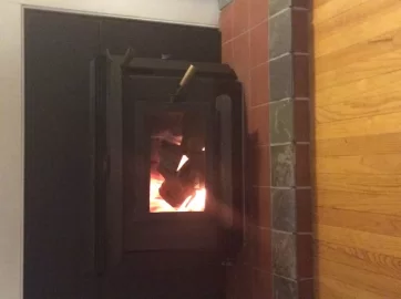

Fired up the BK for the first time!
tigger
Burning Hunk
Dec 8, 2013
186
Rhode Island
It's in the 50's and raining here. The wife came home from school with the chills. Not any more! Stove throws some heat!..

I think he pulled the tigger. :) Looking good tig.
Nice!
Get er going good then turn the t-stat all the way down and let her go on low cruise if you really want to be impressed..lol.
Be sure to show her how the cat is glowing at least 2 or 3 times tonight ,drove my wife nuts with that the first season. lol
