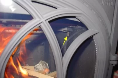

Could you expound on the removal of the secondary air chamber assembly, please? I foresee someday pulling mine out for a check, and seeing how you have done it already...!
How difficult was it to re-install, especially getting the gasket in place?
Thanks!
It takes about 30 seconds to remove and you don't even need any tools. You rotate the two side clips forward. (See yellow arrow in picture.) Jotul says you can use a hammer to knock them free if they are stuck. Pulling down on the secondary air chamber relieves some of the pressure and makes this easier. I did mine with my bare hands. Now the secondary air chamber assembly is free. The gaskets are cemented to this assembly, so they will come out with it and you don't have to re-position them. You slightly tilt up the assembly to one side so that you can jog it free of the shelf that it sits on. Then it can come out the front door one side first. The maneuvering is a bit tricky, but I did it myself when I reassembled the stove w/ the top already in place. Also, the baffle plate sits on top of this resting freely between its guides. Depending on the size of your hands you can put this on before or after reassmbly. Next time my stove is cooled down I will try to take a picture mid point so that you can see how I maneuvered.
It's kind of like working on a german car - complicated and a bit tricky, but intuitive.
What great description! I totally agree!
Looking forward to those pics of the baffle removal. That'll make my life a lot easier in the spring/summer when I clean the stove and chimney. I was thiking I was going to have to pull the interior pipe and possibly move the stove. Removing the baffle would make life 10x easier.
Also, I did some more research. In Europe there is a regulation that the top of the stove must be free for cleaning. So in Europe they remove the two bolts that hold down the top cover (Jotul actually calls them shipping bolts) and it simply rests on the top of the stove under its own weight. I wouldn't remove them as a tighter stove is better, but Jotul has designed the stove such that the top plate is also easily removed via two 10mm bolts. They are readily accessible from inside the stove once the secondary air chamber is removed.
