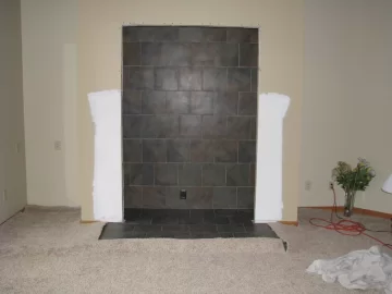

Install pics of my alcove.
  • [Hearth.com] fireplace deemed unsafe to use -options?
Very nice! I love the way that came out. I see you already had a bump out for the fireplace. Mine is flat against the exterior wall so be a lot of extra work for me. Your pics really make me want a stove. I am starting to love the look of them. Some of them are really eye catchers. So far the bay window on the Osburn 2200 has really peaked my interest.
