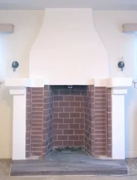

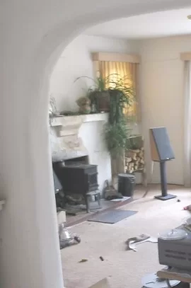

Anyway, there's still some cleanup to be done, but the liner is in, the masonry, plastering, and painting is finished, and today I can finally see what it looks like. I'll install the Morso this week. The paint color isn't right but I'll live with it for now and repaint the whole room at some point.
I've attached a couple pics, one taken last winter with the F602 installed, and the one taken today. The camera angles aren't the same, but this was the only 'before' shot that showed the funky condition of the old fireplace. The concrete mantle in that pic was poured in 1930, that stuff was hard as rock! It was BIG FUN smashing it out while still retaining the columns on either end.
You can see, the shape above the bricks going to the ceiling is decidedly feminine... it's awful tempting to put a few suggestive lines here and there to guide the imagination... :-)

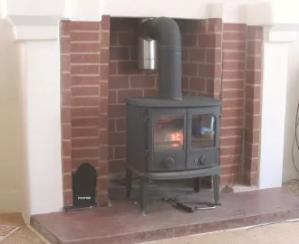

I finished the stove install yesterday. Only thing that remains is to seal the blockoff plate and inside pipe and... clean up. Made a fire this morning to take the chill off, everything works superbly! The attached pic was taken after the flames subsided. (Photographing black objects against a white background is hard!)
The 14' chimney draws like crazy, and the Morso loves it. To insulate the rigid liner, I bought a 25' roll of 1/4" ceramic blanket, wrapped two layers around each pipe section, and secured with chicken wire. Total cost around $40.
