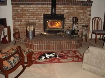

Fireplace Insert Advice for Newbie (floorplan & pics incl.)
Ask them pretty please. If they are decent folk they should oblige a quick measurement.
Guessing from the picture I would estimate the opening at 27-30" high.

Is there an easy way to add onto a hearth to make it wider? It doesn't seem easy. Or, an easy way to remove the hearth and add a new one? Again, doesn't seem easy...

It's easier to determine this with some examination. Sometimes it can be done if the final top surface spans the old and new hearth.
How much in love are you with current style and design of the fireplace black brickwork? If not at all, take the old out and build new.
You can paint that brick a different color, if you want. But trying to get the existing paint off to reveal the underlying brick is next to impossible. I tried it once, and it was ridiculous, so I ended up just repainting it. A sandblaster would be the best tool for the job, and even with that, what you'll end up with, in all likelihood, is a surface that has that "used brick" appearance that many people seem to find quite attractive. But you'll probably have to bring in a professional to do that for you. A mason could extend the existing brick hearth, then you could finish it all to match. Or, if it's not a question of support for the insert or stove, but just a question of the required clearance to combustibles in front of the appliance, you can add floor protection out in front of the existing hearth, and around the sides if necessary, or just for looks if that appeals to you. Rick

Not so much. I don't much like it at all. I'm not sure how difficult it will be for us to remove the old fireplace, and then the expense of the new one.
Probably, we'd like to paint over the existing one. I just really need to get in there and measure everything. We live out of state, so I can't just pop over until next week.
Depending on how it is made you might be able to remove just the cut faced bricks that surround the fireplace and maybe completely remove the hearth in front. Then you could face the fireplace in your preferred treatment and build a deep hearth.

Is it ridiculous to put a freestanding stove in my house? Looking at my floorplan, and remembering what all the various walls/doorways look like, there really isn't anywhere else to put a stove that makes sense, except where the fireplace already is. I'd have to have one heck of a hearth added to my fireplace to have a PE Alderlea T6 (or, more likely, T4 or T5) freestanding in front of it.
Does the T6 really hold heat like soapstone, as you said in your review? Am I nuts to even consider a freestanding stove?
I don't think you're nuts to want to be warm this winter, but can't recommend the T6 here. The reason is that you need a rear-exit flue stove for the fireplace. The Alderleas are great stoves, but not ideal for a fireplace installation unless the fireplace is tall and the stove can be placed deep into the fireplace. Looking at the picture, I doubt it, but certainly could be wrong.
It will be easier to figure all of this out next week when you can provide accurate dimensions for the fireplace. So far it looks like a nice soapstone or perhaps a cast iron Jotul F500 (Oslo) will work best in this installation if you want a freestanding stove.
Well...not necessarily. If you're willing to lose the mantle, rebuild the hearth (extended/reconfigured), seal up and decommission the old fireplace completely, and run a stovepipe straight up from the stove through the ceiling and roof, then you can have just about anything you want. Rick

Is this something a clever DIYer can figure out, or shall I call up a mason and get a quote that will knock me firmly back into insert shopping?
There are freestandings like the Hearthstone Homestead and maybe the Jotul Oslo that look and work great on a hearth. Given your desire to have a cooktop, an insert may disappoint. In order to accommodate a stove like the Alderlea T5 or T6, the hearth would need to be extended. These are deep stoves.
However, it will be much easier to figure out options once you are in the house and can measure the fireplace, assess the flue and consult with a mason. One thing for sure, it'll cost ya. But a good mason may guide you into options and even help you out if you want to do part of the work yourself.

He is saying, (correctly), that only "hearth-shaped" stoves will fit on your traditional hearth. If you still want to cook on an insert, there is the Regency H2100 (broken link removed to http://www.regency-fire.com/Wood/Inserts/H2100/index.php)
I coveted on of these for a long while, but found the firebox to be small, and I don't know how I would sweep the chimney without moving the thing every year. (Might've been able to work it out though.) After careful evaluation, most find that the cooking bit isn't so important.

At any rate, I'm back for more advice. We had the wood stove dealer (the only one I can find in the area so far) come out and look. He really only sells Regency and Hearthstone, though he officially carries other brands. (He just doesn't install them much, nor does he push them, because he's obviously more comfortable with the other two.) He recommended the Regency insert or the Hearthstone Homestead. He does not carry Pacific Energy, which is kind of a bummer.
The Regency insert would only require that we add cement board and tile on the floor in front of the existing raised hearth (which is only about 14" deep, btw). We can do that ourselves pretty easily.
The Homestead would require extending the raised hearth, removing the current limestone slab, and putting another larger one top of the new hearth. More work, more money. But in the end, pretty soapstone, and more even warmth.
We're leaning toward the Regency insert. Seems easier. I'm not thrilled about the idea of an insert, as I don't want to have to rely on an electric fan to get the best efficiency. Any thoughts on these inserts? The reviews seem alright, but it's obvious that this insert won't keep us toasty during power outages (unless we bunk up in the living room).
