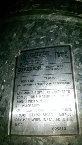

Take a mirror up in the attic and see if there is a label anywhere on the backside of the pipe. It may be embossed in the metal. Look for something like SL3 or a UL certification.

(broken link removed to http://www.chimneysweeponline.com/fswood.htm)
Ul listing on the flue.
That is Superior's TF10 Thru-Flow Chimney System. I believe the outer jacket is air cooled.
If you are considering an insert installation you will need to have documentation of its permissibility. I would contact Superior with the specifics on your fireplace model and the insert you are considering to install and see if they approve. If they do, get this approval in writing.
