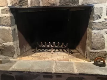

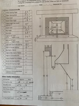

Good Day, thanks for the past thoughts on this project. I have taken a few more measurements and thought I would post to help with making a choice for an insert. Please see attached.
Room size:
325 sq ' first floor
325 sq' second floor - stairs on far end of room from insert - vents in floor currently
Stone walls, 18-24"thick. Drafty and cool. Old stone work farm house section of house
Current fireplace info:
50W x 34H opening
Firebox depth 28"
Raised hearth - 18" (but only 12" deep, will need to extend at floor level)
Rear firebox 14"H
Rear Width 37"
Heigth at 18" = 34"
Width at 18" = 44"
Masonary Chimney - 15'
Terracotta lined 16" x 11" inside measurement
As mentioned in previous posts - Interested in the tax break if applicable.
Possible units -
Regency i2500 Hybrid - tax credit
Osborn 2000 or 2700 - no tax credit
Ashforf 25 - tax credit, but may not be happy with local dealership
QF and VC are fixed rate burners, staying away from them as I like the control
6" SS liner - was quoted the Heavyflex 304 liner at a $350 premium to the Heavylite 304 and smooth wall. Worth it?
I also will be looking for a block off plate - how thick?
Insulation of the existing firebox - best way to do that?
Thank you all for your guidance and feedback.

Re-visiting this project in order to make something happen. I have had the fireplace inspected twice. First inspection as mentioned in earlier chain, fireplace failed inspection. Rusted firebox and mortar missing from inside the chimney.
Update - I have had a Chimney Pro come the second time and take a look at rebuilding the fire place to keep it a fireplace. His response after inspection was that the measurements were 2 inches over the largest "kit" that he could find. Explanation was that reflective baffles would be used to rebuild the metal fire box after it was removed. Largest size he could find was 48". I believe he was using 50" as the measurement he was looking to work with. His recommendation is to instal a free standing stove with flex pipe. I was trying to stay away from this option as we have two wood stoves already on the property, and would like the old fireplace to be usable.
Questions:
1- If I was to have a mason rebuild the firebox with proper fire brick, what is the recommended flue repair? Liner? Flex?
2- I assume new damper and proper lintel dimensions are required? Is that masonry or are there kits?
3- Is anyone familiar with these rebuilding kits? If so, does 50" seem like a limitation to any product on the market?
Thanks for your guidance and feedback,
Dave
