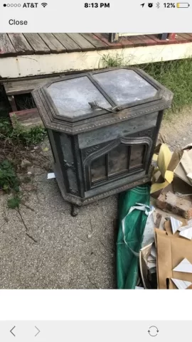

Found this on CL tonight, it's close by and I'm going to look at it tomorrow after work. He is asking $600 or best offer. With out seeing it person and if everything checks out good, what do you think it's worth? [Hearth.com] Fireview on CL

You need to know how many years it was burned. Were they heating full time or not? Also try calling WS when you know some more info, they have no problem helping. It's hard to find a FV in good condition for only $600.

I went to take a look at it and I had to pass. It was a old stove and the flue looked like it was 4'. You opened the top lid and there was the inside of the fire box. I don't if anything was missing or not, it just didn't look right.
I think your gut was right. When you open the top lid, you should be looking at a cat or at least the surface to mount a cat and the damper. If you were looking straight into the firebox it was gutted. Don't look back.
