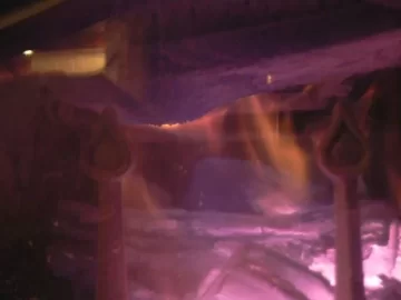

  • [Hearth.com] Fireview overfire?

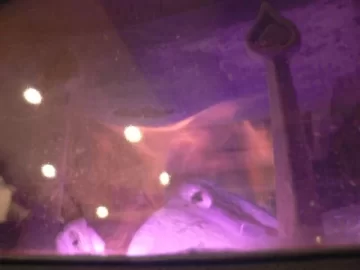

Hopefully that is the only thing that is warped. I'd check the bypass damper as well. Looks like major overfire to do that kind of damage? What air setting do you normally burn at?

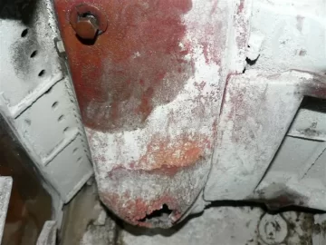

WarmInIowaWhoa! What the heck!?!?!? What the heck is that white stuff??? And that hole in the combustor scoop is amazing! How old is your Fireview and do you use it 24/7?
I have also measured above 750F at the exit point on the stove - but just for brief periods when as you say the flame is roaring up the flue in bypass mode. I try to keep it under 600 and I only got over 700 a few times just after we got the stove and I was still getting used to it. There should be no reason to hit those 600+ temps, I get the stovetop up to 250 or higher and stay below 600 at the exit point.The pipes are really clicking away at those higher temps.
My stove is from 2006. Yes, it runs 24/7 from Oct to the end of March and a little in Sept and April. The white stuff is just ash coating the inside of the firebox. the red area was wetted with WD40 to get the bolts loose. No worries, it will be cleaned up before I re-ignite in a few days.
Sounds like I need to damp it down more when in bypass during reloads. Interesting, it doesn't seem as though I run the stove too hot, but maybe the damper needs to be more shut during bypass and during normal operation. Less flames is better! In the past I have set the air slide between 0.8 - 1.2 and then leave it alone for 5-8 hours until I reload. I think what I need to do it close it up a touch more as the cat is engaged and then open it up a little if necessary as the burn progresses.

I just had an amazing burn by following advice to engage at 1.0 and leave it alone - the stove top hit 600 and I had stovetop temps above 500 for about 3 hrs with remaining flames towards the end of the 3 hrs- this was really exciting! It was a really amazing burn! And The room temp soared to 74F! But now I am worried I may damage the combustor scoop!?!?
The question: Is the scoop damage occurring during bypass mode or when the cat is engaged and flames are roaring into the scoop? It seems during bypass mode the flames are directed out the rear and away from the scoop, so the damage must happen during the first hour after engaging at 1.0 or higher?

As far as the scoop goes I think most of the damage happens in the cat mode but if you are burning wide open in the bypass mode and suddenly flip the lever your going to suck a lot of heat and flame up forward to the scoop and cat, almost like a thermo shock. Probably better to back off some before engaging. Woodstock says the scoop usually don't last forever. They take a lot of heat from the flames below and the cat above, kind of a double wammy. Mine has a slight sag in the middle after 4 years and I will prolly replace it with a new stainless scoop next year. Woodstock is also looking into changes for the andirons, bypass and glass retainer.
