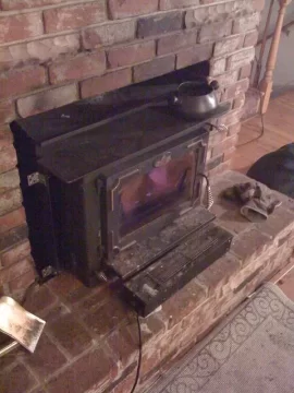

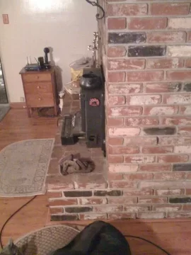

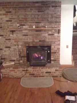

The fireplace opening is 25 inches tall by 35 inches wide, hearth lip extends 18 inches from the fireplace opening
I'm really liking the blazeking, but I also really like the woodstock. I'm a long-burn lover, being how I work 12 hour shifts, night shift and the girlfriend likes to be warm while i'm gone.
I just found the paperwork for the house, the main floor, where we spend most of our time is 644 square feet. The upstairs, which is the master bedroom, two other bedrooms and the bathroom is 572 square feet.
The downstairs, which has another insert...**no liner, slammer instal** which I don't use is 572 square feet. 1788 sq. ft. total. It's really, really cold down there, because it's a daylight finished basement.
And my chimney, that I use upstairs is fully lined 6 inch SS liner, thanks to this website.
Will the blazeking be overkill? If I set a huge stove in here will I roast myself out?
Here are some pictures of the hearth, thinking I might have to modify it.

A fireview work nicely for you I think, but would take up some room. Would it fit on existing raised hearth? You actually want a little room behind it for access to controls. Could you extend the raised hearth section to put it on, maybe? Hmm, lifting 500 lbs up onto a raised hearth, maybe not. You need a minimum of 8 " of hearth pad in front of FV, and its 20" deep or so. Figure 30-32 inches deep of hearth pad in front of your raised hearth, and at least 18" to the right of the stove (where the loading door is). The easiest thing would be to buy one of their pads. Then you could take it with you. What about the liner? If the flue isn't lined do you want to invest in one in a rental house?

What brand insert is that? Is the chimney already lined? The reason I'm asking is that it seems like an awful lot of work and effort in a house you are renting. You probably won't be able to modify the hearth, at least if it were my house I wouldn't let tenets do anything permanent like that. Now if it's already lined then I would think it could be easier, but wonder what kind of stove you can put in there. Not only that whether you'd be happy with it because stove in fireplaces really do need a blower to get the heat out. I've tried both and without the blower it's fan city which makes more noise than the blower.

The stove that is sitting there is an older, beat up, badly over-fired Osburn.
I kind of want to knock down the raised heart. Has anyone done this?
Well if your buying the house I'd call a mason and see if it's possible to just brick up that fireplace opening around your liner and turn that fireplace into a stove hearth. You might be able to save the bricks on the elevated hearth or match them up at a local masonry yard. A Fireview would look awful nice sitting there.

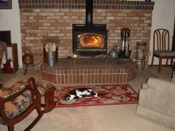

Here's a pic of my fireplace with my Fireview on the hearth.
That looks really, really good chief.
I'm thinking i'm going to have to modify the hearth is some way. How tall is the flue exit on the fireview? I'm not sure that my fireplace opening is high enough.
Believe it or not i only have 10 FT of flue with an outside air kit and have great draft. Maybe i'm lucky but the stove appears to draft really well. So good in fact on 2 occasions after loading i've heard a loud roar and my flue pipe was a little red. I shut down the air and it stopped. I don't know if it would be called a chimney fire because i was able to stop it by shutting down the air. Plus it happened when it was fairly new, a month or so into burning. Maybe just a newbie mistake.
As far as the stove goes i love it. The customer service is the best i've ever dealt with for anything i've ever bought. I spent 4 hours in there factory getting the grand tour. They run a lot of sales. I got mine in the spring. $500 off the stove and free shipping. 10% off accessories.
You'll be happy with the Fireview.

Rear flue exit center is 22.75 inches, 6 inch pipe so the top of a single wall pipe would be 25.75". If you have 27" you will be fine

I just out the ole' tape measure to the fireplace opening. My measurment is 25 inches...about, it was a quick rough measurment.
I'm thinking I might have to take out a layer of brick on the raise hearth..
