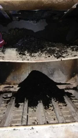

Soot eater! That's what I use. Don't need to get on the roof.
