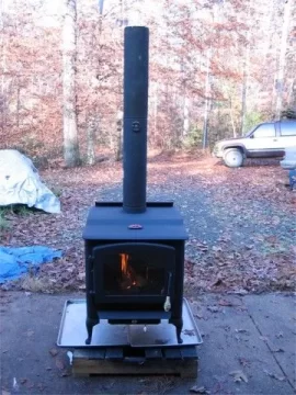

[Hearth.com] First fire to help get rid of smell First fire (outside to cure the stove, get the new smell off and get it ready for some heavy duty heating) It will be a bit before everything is ready in the house for this to move in LOL Will work on new chimney this weekend and also hearth. Notice the rusty old pipe...it is the one we use when we make syrup LOL but hey it worked for this for now!!!
