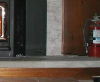

I had to tile around my insert so I concealed the cord behind the tile and I'm going to run it behind the paneling. This is a safe way to do it because the cord is running the same way it normally would except it's concealed. It's sandwhiched between two pieces of marble so I doubt it's getting very hot. I can feel the exposed marble and it's cool. I do like the concealed cord idea alot just make sure you do it in a safe way. Maybe you put a cord on it with high temperature insualtion.

In PA it's totally illegal to put that cord in the wall. You can run an outlet to it in the wall with romex, but not conceal the cord.
DEFINITE CODE VIOLATION!! Electrical codes prohibit concealing appliance cords, and frown on even fastening them down other than temporarily. The only sort of electrical cable that can be concealed is permanently installed fixed house wiring - i.e. Romex cable.
It probably would have been OK if you had left a space between the tiles to form a groove that the cable could have fit into, but hiding it completely behind the tile and or paneling is absolutely NOT LEGAL... You must be able to pull the plug and follow the cable all the way back to the device.
