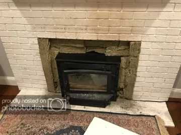

I heat 1500 sq ft ranch with a enviro insert I bought. I don't have a block off plate but have as much safe and sound as I could fit up in the chimney. My chimney is also exterior. The rear bedroom was sitting at 70 last night. I don't have ideal wood this winter and I am still satisfied with the insert. My gas bill last month was $70 cheaper than last January and I was only living in the house half the month last January. This month will be a good comparison. I plan on doing a block off plate at the end of next summer and Have a good stack of wood ready for next season.

Okay, so I finally got around to doing the block off plate. Man it was a big and filthy job and took me about 7 hours from start to finish. I used 1 and a half bundles of Roxul Comfortbat R15, stuffed it as high as I could get it and packed it in tight. Lowes didn't have silicon high temp caulk so I ended up using the 3M fireblock cement type caulk. I wish I would have bought 2 as I ended up not having enough. Will fill the rest in when I sweep next fall.
Taking the insert out while my son watches TV and my daughter help with the vacuum:
Stuff the roxul comfortbat R15 up as far as I could get it and packing it tight.
Mocking up the block off plate. My chimney is not uniform so it took a lot of tweaking the cardboard.
Transferring it on the 4x2 foot sheet metal.
There she is:
This is where I just started to get sick of everything and just wanted to get it done. This was about 6 hours after starting. The plan was to screw the block off plate to the bottom of the metal lintel but I kept breaking metal screws. I just said screw it and bent the metal and put it behind the lintel and filled the gap as tight as I could with Roxul and caulk. I figure it'll be good enough. Here's where I ran out of the caulk, you can see it between the lintel block off plate. I also wanted to create another piece of metal with a 6.25" circle hole but decided it was getting late and figured with all the roxul up there and packed around the liner it should be good. Thoughts?
Roxul on back and sides, block off plate, chimney filled with Roxul, roxul stuffed around liner.
I stuffed Roxul on back and sides of insert. Is this okay?
And here she burns.

So where does the air come out on top of the stove? I see the side vents...but it almost looks like the roxul is blocking the hot air exit on the top? I dunno, my Drolet 1400i is a bit different...I wouldn't have the roxul sitting directly on the stove top...air jacket only

It’s not blocking the air coming out. The air comes out in the gap between the air control slider and top. With that said, you think I should remove it from above?
Ah, OK...so the roxul is only against the air jacket, not the actual stove top...you're good then.
I think you are gonna notice a huge difference now...

I guess I’m confused. The roxul is sitting on top of the fireplace insert. Is that the top of the air jacket like you’re referring?
You said the air comes out between the air control slider and the top...so that means the roxul cant be sitting on the actual stove top, but on the air jacket that surrounds the stove body on insert style stoves

I'm not sure I'd be comfortable packing insulation around and on top of the stove (it is outside the jacket), without getting the ok from the manufacturer. I'd probably want at least a little air gap. Might get too hot.
But, if the manufacturer says it's ok, it might really be great.
My insulation is touching the back, as there was no space for a gap.
Just don't want to melt the thing down, if you can help it.

I don't think it's a big problem but you are aware that all you had to really do with the insulation was wedge enough around the liner and damper frame at the top of the firebox to firmly stay in place....right? Stuffing it up the chimney and packing around the firebox is a bit of overkill but not necessarily bad though. I would definitely suggest checking with the stove mfg. to make sure that isn't an issue though.
Hogwildz
You can use regular silicone around the perimeter of the block off plate. I myself would install a 2pc plate with the circle cut out to cover the square hole left around the liner penetration.
From what I have seen, unless I am missing something, your insert does not have a outer casing shell. If that is the case, packing Roxul against it on top side & back while will raise fire box temps, will also insulate & limit heat dispersion from the insert to the room/home. You want heat from the insert to heat the air around it to convect into the home. With a block off plate installed, there is no real reason to insulate the top of the insert at all. There is such a thing as too much of a good thing, and in your case I think you are going to limit heat from being transferred from the insert.
You may want to consider removing the second inner layer of the roxul all around the insert, at least the top and sides. You want it against the old firebox, but not against the insert .
Personally I think you'll notice a huge difference in heat output now that your not putting all your heat up the chimney. I've owned two inserts in my life a Lopi Liberty and a Quadrafire 5100, both of them would run us out of a 3000 sf house. Much of it has to do with house design. Best of luck.
Hogwildz
Block off plate is always a must in my opinion. His manual even advises on a block off plate. And surprisingly, they do advise you can just basically stuff Roxul up there, but it does note that a plate is more superior. Kudos to them for giving good info.

I have a laser thermometer so that’s where I’m getting the temps. I just open the door and point it at the logs.
Overall, It’s quite a difference for sure. It’s 23 here right now and with my thermostat on the other side of the house it’s currently at 66 degrees. The room that the fireplace is in is rather hot and walking towards the room you definitely feel the temp rise considerably. Better than before. I may get a fan and blow the cold air from the other side of the house into the fireplace room. I hear these stories of people get 75+ degree temps in their whole house when it’s -0 outside. I’m still not there yet so a little disappointed. I just think I need a bigger insert??? 1.5 cu ft is tiny. A guy buy me was selling a CW2900 but I was too late. 2.4 cu ft fire box is huge compared to what I have now!
Anyways. I removed the insulation from directly around the insert based on your comments so thank you all for the replies. When I removed it it was very hot to the touch (fire was going) so hopefully the heat absorbed by the insulation will now come out past the shroud into the room? Hopefully get some extra heat.

The exterior chimney is worth insulating given insulation is cheap, he is already their working on it and trying to get better insert stove performance.
Here is the diagram specs, albiet the Century specs, as CFM is now Century SBI. It looks jacketed.
http://sbiweb.blob.core.windows.net/media/1465/cb00019_cw2500.pdf
Different design than what I am used to seeing. Looks like the jacket is part of the insert, rather than a separate shell attached but removable. Also looks like limited space between the jacket & the firebox, with some venting holes on each side.
I like the way the Summit is set up as the outer casing has a few inches between it and the firebox, and with the vented corner plates on each side, additional heated air can convect from those.
