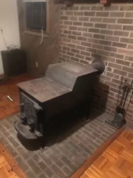

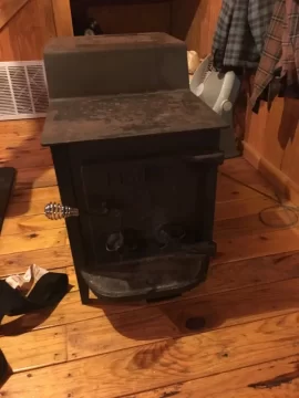

I just purchased a Fisher Papa Bear (I believe it to be a Papa bear). I plan to install it later this week. I do have a few questions.
1. I have researched a lot on the internet to find the height of the legs on this stove. If I understand correctly, i need 6" of clearance with a standard stove mat. Anyone know the height of these legs? I cant get to the stove right now, and i forgot to measure the legs.
2. Will i need a stove door gasket? It doesn't currently have one, and the manual i have doesn't show one.
Any help is greatly appreciated.

Welcome to the forum! Yes, you have a Papa Bear, and no, your stove didnt come with a door gasket, and therefore shouldn't need one.
Someone should be along soon to talk about clearances. It might help them if you post some pics of where you are installing the stove.
Do you plan to remove the rust and paint it before you install the stove?

Still not sure if a stove mat would be enough insulation on the plank flooring is n your 2nd picture. My Mama Bear gets hot on the bottom, but I've never measured the temperature of my hearth under the stove.

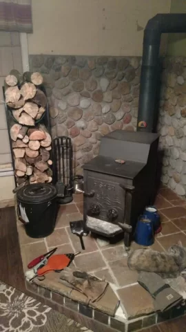

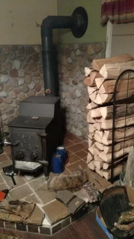

I had very old hardwood floors in my house, so I went a little overboard when I built my hearth for my Mama Bear. I even added a floor jack in my basement under the hearth to support the extra weight. I built my hearth big enough to be able to stack wet, frozen wood on without soaking our old wood floors.
Here is how I built my hearth

I used metal 2x4's, two layers of cement board on the floor & walls of the hearth, then paver stoves on the floor of the hearth. The rocks on the back walls were made by my wife from a concrete/vermiculite mixture. She stained the paving stones and painted the home made rocks.
Here is a link to the thread I posted in 2012 that covers all the details of the installation.
https://www.hearth.com/talk/threads/mama-bear-restoration-and-installation-project.91558/
