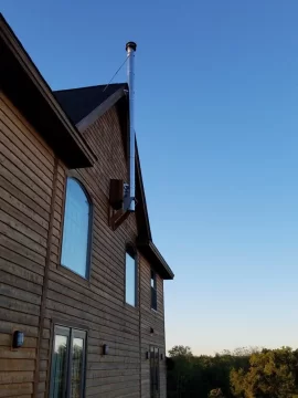

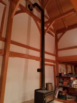

I currently have a us stove 2007b. I am wanting to upgrade to an englander 30 nc. I have 15 ft of single wall flue pipe that has two 45 degree turns then exits house. Manual for the engrander states I can't have more than10 ft.
My question is can i get away with the extra 5 feet without having to buy more double wall pipe?...chimney on outside I'd double walled going up 20 or so feet and is 6 feet above roof..

That's a LOT of cubic air above the stove. Got a ceiling fan?

Double wall stove pipe is not the same as double-wall chimney pipe. It will help keep the flue gases hotter in that long pipe run and thus should keep the flue system cleaner.

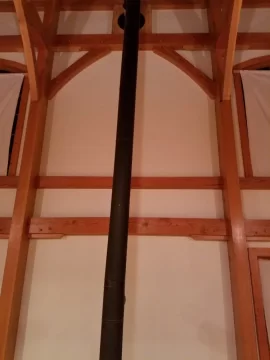

If changing the single wall out to double wall the clearance to combustibles goes from 18" to 6", I'd lose the T clean out on the bottom of the stove, push the stove further back (watch clearance on the new stove) and go up with the new pipe using the same concept of (2) 45's into the through the wall kit. I would also look into more pipe bracing , even if you have to buy and paint it black.

How do you clean out the horizontal section up there? If that was mine I would change it out to through the roof instead of the wall.

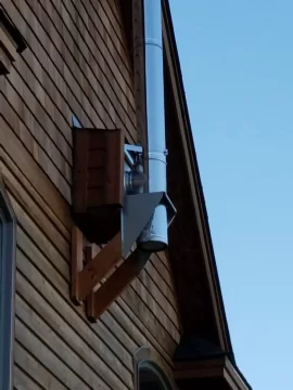

My buddy has a bucket truck we use. Was once scared of heights but not now! I use a flexible rod and brush. Takes 2 people to get it done. One in bucket truck up high and another inside house
