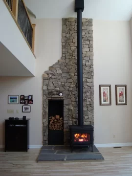

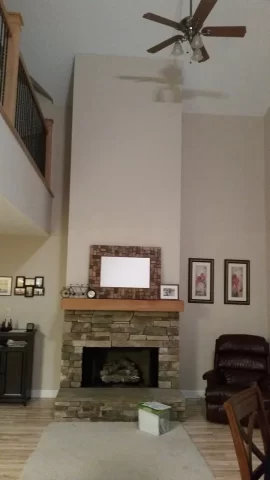

So, I ripped out a ventless gas set up. It smelled, provided not much in the way of heat, cost a fortune in propane and had absolutely no soul whatsoever. I had considered a zero clearance fireplace for months before settling on the stove. There were many reasons for this and this post is long enough so write me if you want to know more about my choice, but the main issue was that it was more costly and I would needed a blower and there were lots of posts about the noise blowers make. No dis on those that have FPs, but I just decided it wasn’t for me after some homework.
I got the Pacific Energy Alderlea T6. I have 2300sqft+ with a large vaulted ceiling with a 2 BR loft overhanging the great room. The floor plan is very open and has a 23' ceiling so I was only looking at the biggest models by vendor. I posted before/after pictures. I hope you like them!

Great heater and beautiful hearth. Glad the place helped.

You made a good choice and the reno looks great.

Good choice, I approve. :) That is a beautiful installation. How is the stove working out with the cathedral ceiling and the loft? What are you using to even out the heat in the loft and high ceiling area and how is that working out for you.

Yes it's a gorgeous install. I have to ask the same question, how is that stove doing in 2300 sf with tall ceilings?

So far, the stove is working great in my large, open space. But, I've only done ONE break in burn so far and not in the best conditions for a good data point. Ask me again after the first cold week and I'll probably have a better assessment.
But, having said that, here's what I've observed so far: I started it up about 2:00pm yesterday and burned all evening. At 11, I stuffed it pretty full to see how it would do overnight. I woke up to warm ashes and put a few pieces of kindling in and it lit right up. It got down to low 40s overnight but it was warm in the house when I got up. I have 2 ceiling fans over the great room and one in the loft. I took a picture showing the 2 in the great room and you can just see the blades of the loft fan in the left of the picture. One of the bedrooms upstairs has a fan as well.
Yesterday, I had just the two fans in the great room going at top speed while I was burning and it seemed very pleasant everywhere in the house and I was trying to keep the fire pretty HOT per my installers recommendation to break it in. But, I also had all the doors and windows open because it was 68 degrees outside and the smell wasn't pleasant for the first few hours of burning. It seems fine now, so I guess I'm broken in! Honestly, it was damn pleasant in the house everywhere all day yesterday with lots of cool cross breeze and the warmth of fire. I was cleaning up all the construction dust and putting my home back together (I had some other work done in the remodel besides the stove) so I was moving around, climbing stairs, mopping, moving furniture and the like and I wasn't hot at all. This morning, it's cool outside (40s when I woke up. 54 now) and I've got 3 windows open and a small-ish fire and one fan going. It's simply heavenly in here right now with the contrast of a cool-ish breeze and the warmth of the fire. I'm LOVING it.
I have a separate thermostat for the upstairs loft (central heat is propane forced air downstairs and a heat pump upstairs) so I could watch the temperature difference all day during my burn. Every time I checked, it was no more than about 3 degrees warmer in the loft. But, it's always hotter in the loft no matter what time of year. I think that it's likely going to be pretty hot upstairs at times -- particularly if I've got a big, hot fire going and the house is closed up because it's cold outside. If the fans can't knock the heat down, I guess I'll open the BR windows. Frankly, that's what we had to do pre-stove so I don't know yet if this will make it a worse problem or if we'll just continue with what we're used to.
To Jake's counterpoint about not shopping a dealer first: I guess this could depend on where you live. I imagine there are places where there are many dealers. Not so in my location. Evidently, I'm not in a location where folks like to service. The dealer I did chose (by virtue of picking a PE) was not thrilled about my location and pretty much let me know that at every turn (as I said, not the world's greatest customer service). When I was thinking I would get a fireplace instead early in the project, I shopped a different dealer and they were also not happy about my distance from their shop either -- and these were the two closest places. I don't think my home is so remote -- I'm probably about 45 mins from my dealer -- but I guess they like to work close to home. Jake probably has a point if there are many dealers in your area, but if you're in a place where there are only a few, I stick to my original suggestion to pick the one that you will love working with. I seem to recall a recommendation from my reading on this forum that you should try asking your dealer if they can get a brand they don't normally carry so this may be a good compromise between my point and Jake's counterpoint.
My only "complaint" at all so far is how boring it is. Having had masonry fireplaces all my life and more than my fair share of outdoor fire pits, I'm used to "engaging" a fire pretty routinely to refuel, poke at it, move the logs around and what have you to keep it going at a nice, even rate and to ensure a total burn. I can be entertained with a fire all evening just playing with it and stoking it and keeping it burning the way I like. But, my stove requires absolutely NOTHING from me. I stick the splits in any ol' way and off it goes. No poking, no rearranging, no engaging with it, nothing. Boring. ;-)
When it gets cold outside later in the year and I'm burning a big, hot fire with all the doors closed, I'll post my experience about using the fans to move the heat around and if/how that's working out for me.

Oh it's not that boring. You need to close down the air control in at least two steps. ;) (You are doing that, right?)
For the fans you probably don't need to run them at full speed to get good air mixing. What I would try is to run them with one blowing down and the other reversed and blowing upward. That should create a convective loop, mixing the air and breaking up heat stratification nicely. You should be able to run them on medium speed with good effect.

This is a good idea -- to have them run opposite. I'll try it, but I may not have a full report until I see how it does with a hotter fire and closed up house. Right now, I just have ONE fan going (blowing down) and it's fine. My fire is very small right now because I think I'm more or less "broken in" and I'm just having one to have it because I can... :D
Yesterday, I had the air control full open or mostly open for several hours. I was going for raging hot fire to burn off the initial smell. The flue popped 3, maybe 4 times, which the installer told me it would, but no leaks and all seems well. So, no, I didn't adjust it in 2 steps yesterday! :D
Today, I opened it all the way up to get the kindling lit and left it that way during breakfast and the first cup of coffee. I probably got to fully down in multiple steps over the course of the next hour or so. It's as low as it goes right now and burning low and beautifully. I've still had less than 24h of total burn time so it's not like I'm an expert already. And, I'm admittedly not burning in conditions where I need good heat regulation so I'm sure my technique won't be thoroughly tested and refined until winter.
I've also learned another terrific lesson this morning -- I went out to my wood crib and pulled off some splits. The wood is well seasoned, but I guess there were a few splits in the second or third layer with some bark that held moisture from some recent rain. It's amazing the contrast to watch what good, dry wood will do in this thing vs. something that, while seasoned, has too much moisture. HUGE difference. And, it virtually instantly dirtied up my clean glass. I'm actually glad I saw this so I have a good visual of what "not good" looks like. Glass cleaned right up when I opened the air and put on some good, dry stuff and let it burn hot for a few minutes. I'm going to do a better job keeping the rain off my wood cribs. Outdoor fire pits are pretty damn forgiving so I've been able to be lax about how I store my bonfire wood. This won't do for my stove fuel.

I like your hearth. I've been wondering what kind of hearth I might like to have built in my future home build. I like the wood storage part of yours. What kind of material is the wood storage insert constructed of?
My GC built it out of heavy duty plywood. I took a picture of some scrap we saved so you can see how thick it is. I had to sacrifice part of a closet in the BR behind this wall, but I didn't need that big of a closet and I really wanted the convenience of wood right there next to the stove. I included a picture of how the closet looks too. I'm glad I had a closet to sacrifice or else I probably wouldn't have the wood cubby.
The cubby is about 30" deep so we can actually stack 2 deep even for the longer splits. Typically, he uses the chainsaw bar as his ruler as he cuts pucks so most of our splits end up no longer than 18". Two rows of 18" sticks out some but it works fine and doesn't spill out. My depth was determined by the closet depth so that's why it's 30"
The cabinet on the bottom is about 18" tall. I wanted a spot for the "ugly" stuff I didn't want out on my hearth like ash can, lighter, hearth gloves, etc. And, no, I won't put a bucket of ash I just emptied in a wooden cabinet!! But, I wanted a spot for it when it wasn't needed and I didn't really want to have to bend all the way over (I'm not getting any younger, you know). There are plenty of pictures on the internet where the wood goes all the way down to the floor, but since I could go deeper and double stack, I thought the cabinet would be good for storage and to save my back!
As an aside, the asymmetric design was not what was planned at first. I had originally had the stove centered on the hearth with narrow wood cubbies on either side. But, when we ripped out the gas FP and chase, we learned that the orientation of the floor joist (for the OAK) and the ceiling joist (for the chimney) forced my stove to move right of center. I didn't want to cut out more of the wood floor to make a HUGE hearth and it was going to be a very big problem to try to fill in/patch the flooring where the old hearth was to keep a symmetrical design moved to the right. Plus, I wanted room on the right of the stove for some furniture so I was more or less stuck with the footprint of the original hearth that I took out (about 65" wide). So, I redesigned it to make the asymmetry work and look purposeful. We could have angled the pipes -- there are several examples of people having to bend their pipe stack to get around these issues, but I opted for straight up and down with some asymmetry on the bottom. It actually looks better than I imagined it would when I was sketching it out on paper and going over the options with my GC. He really wanted me to do a symmetrical install and did NOT think it would look good off to one side. He's changed his mind since seeing it finished! ;-D
My original plan was to use cultured ledge stone similar to what is in the "before" picture, but I switched to natural stone veneer just before the mason showed up. I haven't seen the bill for this change yet (still waiting for the final invoice from my GC which I won't get until after I pass inspection) so I hope I'm not going to regret it! I doubt it because I love the way it looks and I'm glad I've got real rock. More soul, IMO.

You should never need to run the stove with the air wide open once the fire is burning vigorously. That will just send most of the heat up the chimney and could overfire the stove. The stove will actually get much hotter by closing down the air, in increments. Closing down the primary air increases the draw on the secondary air ports. This brings about much more complete combustion and a hotter stove. On our stove I usually close it down 50% when the flue temp is approaching 500F (internal temp measured with a probe thermometer). Then wait 5-10 minutes and close the air down until the flames start to get lazy. Let the fire regain strength and close it down again until the flames get lazy again. By now the air will be all the way closed or almost there.

I would guess from the pictures that you have good strong draft with a tall, straight up chimney. It also sounds like your wood supply is nice and dry. All very good for a strong fire. My recommendation times were somewhat generic because I can't see what you see. Feel free to turn down the air sooner if the fire responds well. The point is that one almost never runs the stove with air more than 50% open unless the wood is unseasoned and needs all the air it can get.
FWIW I like to run the stove with two thermometers, one designed for the stove top and a probe thermometer (for double wall stove pipe) to read the flue temps. Condar sells good models for both locations.
