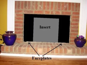

I wish I could put this one in, but my prefab in resessed into the brick about 4 inches (see attached pic) so the faceplates won't fit (even with the offset flue).

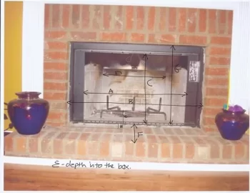

Ok, here’s what I got:
A – 30”
B – 38”
C – 20”
D – 21”
F – 17”
E – 15 ¾”
F – 23”
G – 15 ¾”

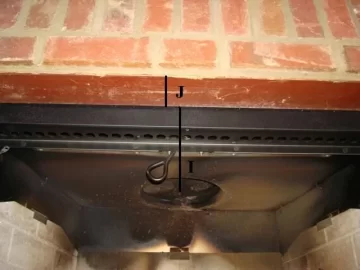

H – 4 ¾”
I – 12 ¾”
J – 4 ¾”
Unless I am mesuring something wrong, my problem is that, even with the offset adapter, the insert will sit right at the end of the prefab opening (leaving 4 ¾” of brick before it hits the edge of the fireplace opening).
Even using the I1200 I will have to custom cut the black faceplates to get them to fit into the recessed brick opening.

Basically, my problem is that the edge of the prefab unit is not flush with the edge of the fireplace opening. There's a 4 and 3/4 inch difference between the two. Once the I1200 is hooked up it will sit at the edge of the prefab opening (not the edge of the fireplace opening).
The HI200 has an offset flue adapter that will move the flue center line to 14 -1/8" from the back of the faceplate. Based on your measurements it could possibly fit
There lies my problem... I need 17" from the flue center line to the back of the faceplate... :( This would allow the faceplate to sit flush with the brick opening of the fireplace.
So I don't think I have much choice, but to go with the I1200 and cut their faceplate to fit inside of the recessed opening (I drew this out in the pic in my first post). Thoughts?
So, unless anyone else has any suggestions, I think I'm going to have to go with the I1200.
