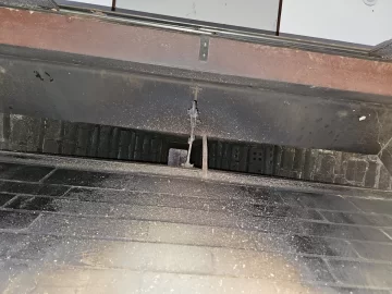

Bricks are 12" so easy to see the scale. I was wrong. Chimney is 12' x 3' + the lower extension. Pic of mechanical door opening. It opens a door that goes along the wall to both side walls.past the door the bricks are tapered(little hard to see) from the 5 feet wide down to the smaller size that goes up to the roof. Reverse ranch MCM so this is top story. That little square in the last picture is daylight and the bottom of the chimney cap. I didn't measure the smallest width of the flue, but I could easily feed a 6" round double wall up it myself. Probably 8" as well. Flat roof with easy access to top of chimney. I wouldn't even need a step stool let alone a ladder. I work in architecture. My house is like my pet project.
I'd really love to get some better use out of this. Basement fireplace is offset right of this one, but identical. To the left is all the MEP flue. All the way to the right was a 24" wall oven on the other side. Oven is long gone. I built a built-in cabinet in the space and the cooktop exhaust goes up in there. Before the cabinet I built, I could stand inside there. Tightly!
View attachment 319613View attachment 319614View attachment 319615View attachment 319616
