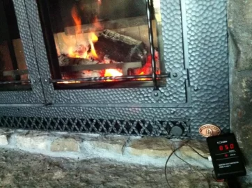

OK, built a nice fire this AM.
With initial load up to the fire bricks the fan kicked on @450 on the thermometer with by-pass engaged (cats NOT on). I waited until the temp meter said 600, then I engaged the cats. Temp rose very quickly to 1050 and stayed there for a good while.
After a couple of hours the coals were low it was cruising at @900 for a pretty good while. You can see the coal bed present in the pic (the readout says 850 because I just poked the fire).
I really don't see how the probe is reading too high as when it said the temp was 1000 that thing was kickin out some heat. At an indicated 850 I couldn't see that the cats were red, however. Not sure what temp they are supposed to glow.
When you engaged the Cat did you notice if it started to glow right away?
Nope. Temp meter needed to climb just north of 1000 before they glowed initially. Once they were lit they rather stayed red to some degree down to 900. Guess it depends on how hot the rest of the firebox is, how long it's been coaling etc.
I will say that after I engaged the cats at 600, immediately after engagement the smoke was the same. At 800 a few minutes later the smoke was considerably LESS as the fire was building (and flames getting higher even) then at about 1000 there was no smoke at all.
