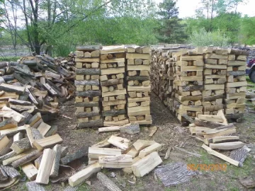

I didn't take pictures (so maybe it didn't happen) lol but last year when I was helping split my parents wood (white oak), I suggested that we criss cross stack everything, we did 5 pallets in a row and it came out great, sat all summer (top covered in September) and was ready to burn in November (resplit a piece had 15% moisture) It def looked like they had more wood than 2 cords but I'm convinced that if you have so so wood in the spring that you need for the next season using this stacking method will def reduce time in the seasoning area. Of course you need to have other good ingredients to, such as sun light and air movement, I will be using this method this year, and I promise to take pictures and show moisture meter results.
I am trying it with 2+ cords of red oak that was green when c/s/s and 2+cords of pine. I will not need this wood till winter of 15-16 or after. But I don't see how some say it will take longer to dry!!! With all the air space between the splits I thought it would dry faster as it is moving air that dries things most.[Hearth.com] Full cribbed stacks?

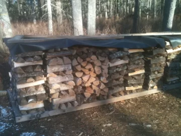

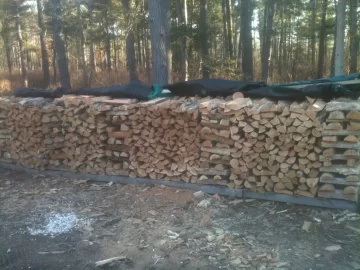

This picture is 2 1/2 cords of red oak stacked 3 splits deep I alternated cribbed and stacked but this was all ready to burn at 20% or less when c/s/s. it was all dead standing :-)
