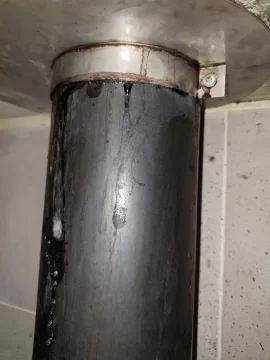

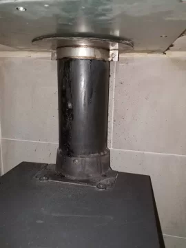

What you are describing sounds like what happens when stove pipe and chimney are installed upside down. Can you post a picture or two of the stove pipe? Maybe one close up showing the dripping joint and then one a bit further back.
Reactions: Andy Pandy
Upside down? It's a straight pipe out of burner into mushroom and into flue. Couple of pics attached. This was after lighting twice after a thorough clean. Hope they help.

then started to get a very acrid smelling liquid residue running down the outside of the enamelled pipe when it gets hot, bubbling and fizzing and stinking the house out.
As stated, it definitely sounds like the pipe is installed incorrectly. The pipes should seat inside of each other in a way that would allow any "liquid" (which is creosote) to run back down inside of the lower pipe. Upper pipes going INTO lower pipes.

That’s a very strange setup for a masonry flue. I’m betting that the pipe simply terminates above that plate into the bottom of the flue. You can see creosote running out around the plate as well as around the pipe. Get someone in there to look at that installation before you use it anymore.

What you seem to have is just a register plate with a hole, enamel pipe through it and (hopefully) ending a few inches above. That is allowed, but sealing is a pain, as you've found!
Looks to me the builder has fabricated that attempted seal.
Google top hat adapter.... You'll find register plate with pipe fitting, this is the better way I believe

Thanks, yes there is an flue adaptor above the register plate, the enamel flue terminates into this just above the plate, I'm suspecting that this adaptor is where the leak is occurring. The builder will be back in the new year and I'll point out all the help and responses to them.
