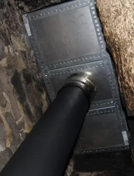

Getting at the stovepipe is easy, as they're big fireplaces (see avatar). Getting to the block-off plate is a little tricky, though. There's actually room for a ladder in each fireplace, but this one in particular has some iron bars running front to back in the tapered smoke-chamber area, and the taper means you almost need to stand on the stove (not recommended) to get at the liner connection.
Here's what I did on the liner he did not finish off (new stove):
[Hearth.com] Furious with my chimney installer
That's a stove pipe to an appliance adaptor, and then the liner, right below the block-off plate. The block-off plate is 18" x 48" (yes, that's a very big flue).

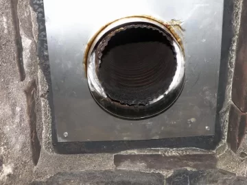

Here's what the installer did on the other stove, where he handled the stove hook-up:
He inserted the stove pipe up into this hole, and likely fiddled with it a bit to get the liner to go into the stovepipe. Then he started sticking the other pieces of stovepipe on below that, and because he did not bother getting a telescoping stovepipe (like I did for the other stove), he must have just held it all there while connecting the reverseable flange onto the back of the Firelight 12. Then he jammed gasket rope up around the stovepipe, where it went thru that collar on the block-off plate.
This stove has one of the common 45-degree reverseable stovepipe flanges, so that it may be switched between top and rear exit. Of course, there was no way for him to get the little 1/4" rope gasket right on that flange while supporting all this stovepipe, so it was a leaky joint, which may be part of my poor draft problems with this stove.

Ok, tough to tell from the photos...but could that block off plate be reversed with the flange/sleeve facing upwards? Would that allow the liner end to be exposed below the block off plate? And if so, would it be enough to connect to the stove pipe and get some screws into the joint?
