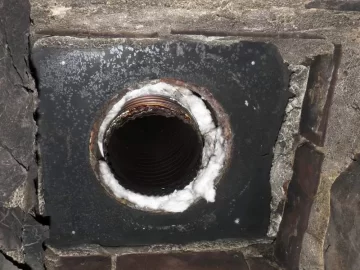

Okay... update! I removed the block-off plate that he added (stupid sheet of stainless with the useless collar), and exposed the original block-off plate, installed by the guys who put the new brick and clay chimney on this old fireplace in 1994:
[Hearth.com] Furious with my chimney installer
So, as anticipated, he ended the liner flush with the bottom of the clay liner. However, I'm happy to see there's plenty of room for the clamp of an appliance adaptor. The only challenge is getting it up onto there and clamped! A 5/16" socket on a small 1/4" ratchet might just squeeze in there. If not, I'll be looking for a way to drop the liner down a bit to make the connection, and then pull it back up.

It looks like there is plenty of room to get a ratchet in there.
