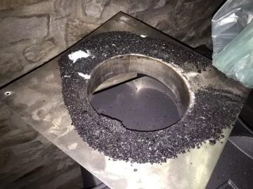

Had an issue tonight with the entire liner moving, when I tried to pull the telescoping pipe down onto the new Ashford. The telescoping stovepipe had been cleaned, and left full up (collapsed) by the sweep, while I swapped out stoves. The telescoping stovepipe segments will not slide, they've been pushed too far together by the sweep.
So, I decided to pull the block off plate, so I could get at the appliance adaptor, to disconnect the telescoping pipe, and take it outside to get it back apart. So, I pull the plate down, the stainless plate with collar shown earlier in this thread, and find a ring of creosote about 1/2" deep on top of the plate. This being a 6" stainless liner with insulation stuffed into an 8" clay tile flue, I'm wondering where this creosote is coming from. The 8" flue was supposedly cleaned before liner install... or so I thought.
Ideas? Should I be concerned, or vacuum and carry on?
Coming from your larger chimney I assume.
Yeah. You never get all of the stuff out of the chimney on a cleaning. Stuff in the mortar joints etc. With heat and time it flakes off.
For it to ignite you already will have a chimney fire at that point on the inside I would think. Smoke in the house bit unless its all cracked up I would thinking be fine
Yeah, just surprised that any of it could get down to the block-off plate, given the blanket wrap on a 6" liner pretty well fills the 8" ID clay tile, let alone the amount that was found.

Aren't your chimneys like 30ft? I dont think thats much creosote for that length. Plus as those things heat and cool the contract and move and the stuff could of just worked loose over time.
This one is short... like 10 feet of lined clay tile chimney. Also, since the blanket-wrapped stainless liner completey fills the clay tile liner, I'm having trouble figuring out how stuff would work down to block off plate, even if there were some small amount of stuff left after cleaning and install.
Well that changes what I said. Maybe it was just poorly cleaned. Since its so short maybe just pull it and clean it and reinstall?
That is if you have the proper clearances to combustibles on the old clay chimney. If not things can get pretty bad pretty quick. Also creosote turns liquid and the last time i went out to a fire that was between old and new liner they had had burning liquid creosote running out the bottom. Like bb said you will never get every last bit out but that looks like allot i would question if it was cleaned at all.
You can get it all if you break out the old liners lol. Actually many times i have to clean the bare brick or block chase after removing the liners because there is creosote there that has leaked through through the years

Well, more interesting stuff tonight. Started wiggling more on the telescoping pipe, me holding the upper, wife pulling on the lower. Still can't get it to budge, but a small bucket load of golf-ball sized creosote rained down on us. So, I started probing some more, and I'll try to describe what I'm seeing.
First, I ordered an "insulated smooth-wall flex liner", and did was here on install day. I saw them take a coil of smooth wall flex liner, unroll it in the driveway, then wrap it in a blanket, foil, tape... and I think there was a wire wrap or sock over that. The intallers had cut the liner very short, perfectly flush with bottom of old clay tile chimney, and crimped the end of the liner to slide inside a stovepipe, with no retaining screws. When I discovered that during my first cleaning, I installed an appliance adaptor (described in preceding pages of this thread) and the telescoping stovepipe.
Well, when I look up now, I see a white insulation on the outside, and my appliance adaptor, with gobs of puffy creosote between the insulation and appliance adaptor. I knocked that all out, and if I stick my hand up farther between the insulation and liner, I feel and see more creosote. Also, I feel a collar covered in foil, about 1" larger than the liner, which may be the sock I remember from the install, but it seems to be rigid... almost as if my 6" flex pipe is inside another rigid pipe. Just can't figure that out (can't see, can only feel, since it's up inside the clay tile liner), and can't figure out why there's so much creosote between the flex liner and insulation. I think it can't have come from the old clay liner, if it's INSIDE the blanket, and there's just way too much to be remnants from a poorly cleaned chimney.
I think it's time to pull the liner, and figure out what's going on. The only question is, do it myself (no second set of hands to help me), bring back the guy who did this install, or take a chance on trying another chimney sweep.
