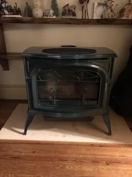

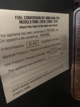

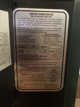

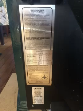

I am new to this forum and have a question about my gas stove. I recently acquired a Vermont Casting 2600 Radiance with a propane set up. I have natural gas in my house and would like to convert the stove. I have been seeing a lot of posts that there is no conversion kits anymore. Is there a way to convert it myself or does anyone have advice on where to look for a used or new conversion kit somewhere out in the world? I bought it not knowing that there was such a lack or material for it.

Locate the serial number on your stove & find your nearest VC dealer.
With the model & serial number he can determine if the LP to NG kit is available.
do we know exactly what is in these conversion kits (ng to p or p to ng)?
Pilot orifice.
Burner Orifice.
Regulator head.
Specification for air shutter setting.
Conversion stickers.
