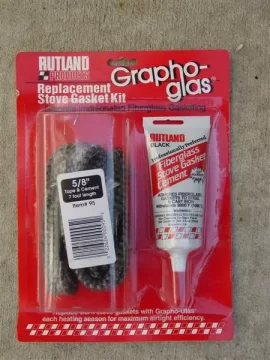

It works very well with the standard fiberglass gasket rope. I buy standard braided gasket rope from McMaster-Carr, rather than the little packages sold by Rutland. I rebuilt two two top-loading stoves with double front doors, ash doors, bypass dampers, and gasketed rear burn plates last year, and feel like I bought nearly a mile of the stuff! One stove looked like it still had original gaskets from 1993, other than the top load door gasket, which I had replaced myself with a grapho gasket in 2011. It began to come loose the first time I caught it with the rough edge of a split. The other stove came with all new grapho gaskets, installed by the seller, which fell off after just a few weeks use.
That grapho top load door gasket that fell off inside of the first year was put on with the cement that it was packaged with:
[Hearth.com] Gasket Cement Recommendations?
I prefer an adhesive for a gasket to a cement. They have different purposes. In the Rutland line, this is their adhesive. It has similar properties of the Meeco product, but I haven't tried it.

Thanks for posting that, begreen. I'll have to check it out, although I've definitely come very close to that 800F limit on my top load door!
Thanks Joful.
I've used that, but only to seal pipe joints.
It doesn't really seem to like heat (weird, for a high temp product), and cracks/flakes by the end of a single season.
Which product, Dave? Three were posted! :lol:
