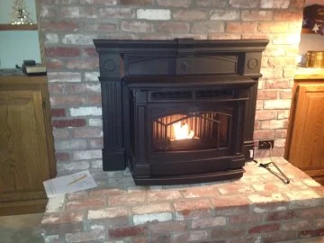

No it is not. They have no clue why, even though they were out here twice for at least an hour each time. It's not so important in summer, but in winter it used to put out enough heat to do the whole downstairs. Now it barely gets the family room up to 75º
This is how it used to burn the whole time, on 3.

Hmmm, is stove on a thermostat? If not, is control board switch in correct position? Does the unit turn on and feed at initial startup and then ignite? If control board does not change settings, maybe a loose connector from motherboard to daughterboard... Hard to know what to do if not there seeing what the stove is not doing. What did the folks say that worked on it? Is combustion motor coming on and running? If its not doing its work, then the vacuum switch will not close, that will not allow auger to feed. Pellet stoves are all about gates, one has to be met so the next one can be performed. It's not a hard system to follow, but if one does not realize what is needed to happen for the next thing to happen, sometimes too its silly stuff, we've all been there. The manual troubleshooting can help too, just some people will not bother with it, cuz "they know how it works already". Unfortunately, I've been there too. Keep at it, it'll get looked at by the right person and she'll be back to running normally. A proper, full cleaning is always, always the first step.

I get a great huge flame at first, but then it dies down to a glow, whereas it used to burn at a medium flame as in the photo above.

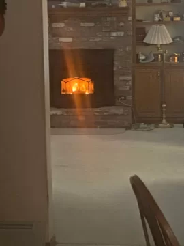

The flame is bright orange but only for about 15 minutes when started.
In the fall, I had it professionally cleaned and they came out a second time and still could not figure out what was wrong.

Just one thing comes to mind, and for you to try
In the room, the stove is open, a window just a crack and see if the stove works better
