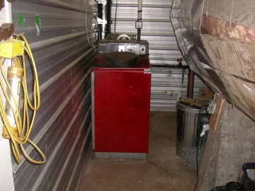

We have a well insulated 1,000 gallon storage tank , and in the summer months can go as many as 14 days between firings, the room that the boiler and storage are located is below grade and towards day 14 that room can get down 45 - 50 degrees . Our boiler is old and uninsulated and can put temperatures in the boiler room up to 110 when firing , the newer boilers that I have seen are well insulated and put very little heat into the room.

Neil, you mentioned the size of that utility room would not be able to fit both a Garn and storage. The Garn unit is so big because it is its own storage and boiler in one. Simplifies the plumbing if nothing else. The Garn takes big hunks of wood too. I have a Tarm Solo Innova, as the Garn was too pricey and at the time I was unable to obtain a Froling. Using your auto analogy, the Froling is like a Mercedes (It's made in Austria, close to Gernany) and the Garn might be a HumVee (an expensive, all purpose vehicle). The Rolls Royce might be one of the Veissman models, still only available in Europe. Frolings (like Effectas, Vigas and others maybe) have Lambda devices which regulate oxygen intake automatically. It is to be easy to use for that and various other reasons. Call Chris Hoskins (1.800.782.9927) up at Tarm Biomass. He could explain the Frolings features much better than I. Many people on this site do drool over them. Their upside and downside both are their computerized sophistication. Use the search function on this site to get some info on them and the Garns, as well as all the other brands (Just thought of another brand, Varmebaronen). All have their up sides, be it cost, design, ease of use and installation, quality of build and manufacture, induced draft, ease of maintenance, longevity, warranty.
