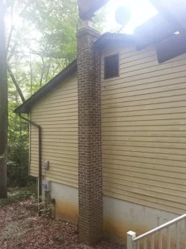

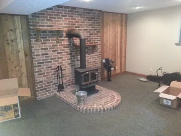

30 year old split level house with a small wood stove, & Hearth, with a 6 inch through-the-wall vent on the 1st floor (the 1st floor is at ground level, not an enclosed basement). The vent goes straight into a 25 ft chimney. Living room and bedrooms are on the second floor.
A chimney inspection found cracks in some of the flue lining so I'm transitioning to a pellet stove with vent liner up the whole chimney (to mitigate the flue cracks).
I desire to have a source of outside air (OAK) for the Pellet Stove to avoid in-door drafts (among other things), however, the pass through to the chimney is only 6 inches so there is no way to get a 4" Vent and a 3" OAK liner up the chimney together. I REALLY want to avoid punching a new 3-4 inch hole through multiple layers of masonry to get outside air, but my intuition says that is probably what would need doin if I want that fresh air.
Has anyone had a similar situation & how did you approach it, or does anyone have some other ideas?

from outside, there seems to be an ash dump door at the bottom.. isn't there a trap close to the base of the hearth? or is that to clean up the chimney only? that could be your OAK entry if there is a way to get to it.
Just a chimney clean out, the only hole on the hearth side is the 6" vent.

After looking at your pics of your fireplace it would be har to hide oak pipes,it looks like your stove is out away from the wall a good distance maybe drill directly in center behind stove near the floor not sure just giving ideas

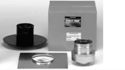

Hello
I had the same exact issue!
So Selkirk DT did the job for me! ⌚️
Just google Selkirk DT Masonry Chimney Conversion Kit!
