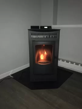

[Hearth.com] Glass cleaning I’m new to pellet stoves, having just had a castle serenity installed in finished basement. Really love it so far. Just curious how much buildup on glass is normal. The buildup I get so far removes easily with damp paper towel. Been 2 days since I wiped glass and and a brown haze most prominent on each side of the glass. Kind of looks like an X-ray of set of lungs. Does this look about normal?
About normal for the Serenity. Don't know if it's the dirty glass but the flame looks too dark orange. Maybe you could get a pic with the glass clean.
I agree flame looks pretty dark. While that kind of buildup is not unusual for a pellet stove, it might be being made worse. Picture is obviously still, but flame almost looks like it might be fairly lazy, might need to figure out a way to increase airflow.

Yes, my wife put it on thermostat setting and the stove was on lowest setting. Have never seen flame that lazy yet. I’m currently going into fire off mode and will start it back up in manual setting to see if it goes back to more normal looking flame.
I'm not familiar with your model of stove, but I know alot of stoves have an adjustable damper that let's in more or less air. Could be something as simple as that, but again, I'm not sure if that ones has an adjustable damper.
How's the insulation in your house? Any drafts? Another option would be an oak, but I didn't have to do that at my house, nice old house with just enough drafts.
