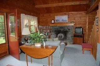

jugarf, Here's more info on the ELM Cast Iron stove
http://www.vermontironstove.com/
  • [Hearth.com] Going Crazy Trying to Decide Which Stove
Well the Elm is certainly an unusual looking stove. How does it work? Is it still made? In Vermont? I'm going to Vermont this weekend. Is there anywhere anyone could recommend that I look at stoves? I'll be near Rutland.
I owned two Elms back in the late 80s and through the 90s; a 24" than switched to the 36" to heat our 3k sq' home. I would have gotten an Elm now, but our shallow hearth would have forced us to turn it sideways. Just didn't want to do that.
The Elms I had were cats. Not made anymore. I liked their unique look, the warming shelves, the soapstone covered combustion chamber (which made great pancakes), and they threw off nice heat. Could fill them with wood easily enough. The new ones rely on secondary combustion, and they are basically the same as other manufacturer's secondary burn tube technology.
The view of the fire is different because of a number of things - the cast iron Dutch Elm tree on the door, as well as the double glass, the outer being rounded (actually Pyrex), so it distorts the actual view of the fire, but you still see things okay.
When I first got my stoves (in Maine, including Elmira and Hearthstone), I was all hyped to sit and watch the fire. Right. I had about as much time to do that as plan for a moon trip. It's great to sit and watch a fire, it's also kind of boring after awhile because you get used to it, and life goes on.
The youtube vids are informative. I've had some correspondence with the maker. Nice guy.
