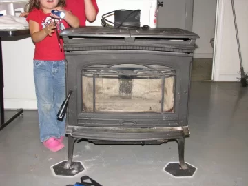

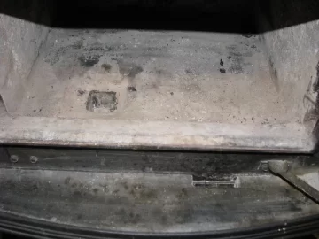

I was able to get a face to face with the stove and confirmed that it is a T6.
The only flaw that I saw was a broken fire brick in the back.
I've posted some pictures and will try to add another post with a couple more pics.
Big thanks to all,
lc
  • [Hearth.com] Going to look at a used T6, what should I consider?

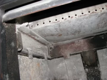

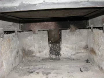

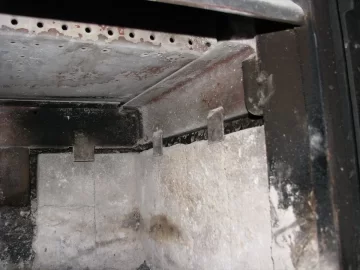

I hope that I showed all the critical areas in the pictures.
From the creosote built up on the top of the fire box I believe that the wood burned was not well seasoned.
The stove was not performing to expectations in heating the basement and then getting heat up to the living area.
Externally the unit looks to be in fine shape. Seals on the doors were in good shape. The one fire brick in the back on the right was cracked.
I hope that the pics show what you need to help identify condition.
Please shoot questions my way. I may have seen more than registered and a good question might help me remember more of what is there.
lc

No questions other than did you get it? If not, go for it!
The only very minor thing I see is the baffle retaining pin appears to be missing. The rear corners, looks like mine-- which after I added the blower noticed the rear corners do seem to burn a little cooler, chimney is fine. The rest of the unit looks like it was used properly.
I'ld say the $1700 is fair and personally would pull the trigger -- if I didn't already have one.
Looks to be in good shape I would pull the trigger if I was looking for one.
