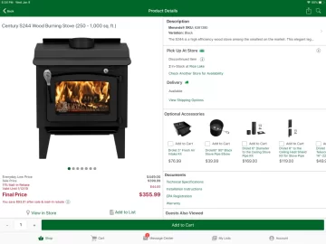

I see Menards has a deal on a Century S244 wood stove. They have them for $355 after in-store rebate and sale price which is $400 less than another local store has them (L&M Supply). There’s a block chimney in the basement with a 6" capped off port it in where a add-on wood furnace used to be hooked into it so I think it should be a easy hookup. I’d use it just when I’m planning on working in the shop downstairs in the winter since it stays around 50 down there when I’m heating with the wood stove upstairs and there no heat in the basement then. Sound good to you too?

Just for spot heat maybe. That's a very small (1.2cf) stove in a basement, so don't expect it to contribute too much towards heating the rest of the house.
Before you pull the trigger, see what condition the chimney is in and what it is going to cost to line it.
I have one. Used it for a couple seasons. It can crank out some serious heat. Burn times are naturally short. If it does not come with a blower I think I still have a link to one on Amazon that fits and works perfect. Very reasonably priced. Mine was a solid little stove. It has a perforated baffle type secondary burn sys. (no tubes) that also uses 4 easily removable firebrick layed flat to close off the rear several inches under the flu collar.
I have a century s244 heating a1100sqft house. Have it going now. We have had it for three years. It's been a great little heater. Only con is short burn time and you really need to make small splits. Larger splits doesn't fit real well or burn as well. At least it doesn't for me. We were looking to upgrade to a bit larger stove last year mainly because of a longer burn time. Never did yet. It's been such a good little stove I'm having a hard time replacing it.

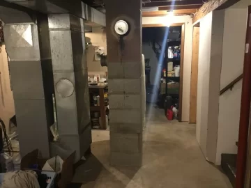

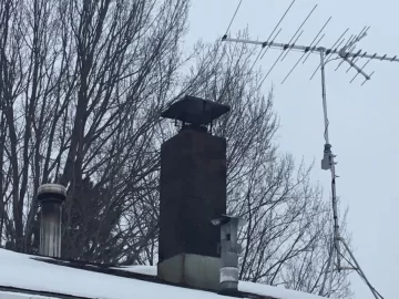

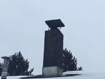

This would just be for a small basement and I have a larger 2.3cf wood stove upstairs. I don’t know what condition my chimney would be considered as... it’s fine inside of the house but above the roof there are some cracked blocks but I think the clay liner is sound but I can’t say for certain. The house is 40 years old as is the chimney. I was thinking that I’d take out the chimney in a few years after I replace the water heater out for a power vented one but I won’t demo it if I get the wood stove. The WH is the only thing that uses the chimney anymore. I took some photos of where I’d put the stove and the chimney itself so you all can see what I’m talking about here. I just got a stainless chimney cap too to replace the old rusting one on it now to eliminate the rust stains from it.

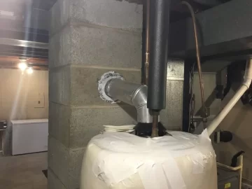

Someone correct me if I'm wrong, but you can't hook up a wood stove to that chimney as the way it seems in the pictures that is the vent for the water heater!
@bholler
Reactions: bholler
In some places it would be legal to drop 2 liners down the chimney, one for each appliance, but it doesn't look like there is room for that from the photos. If there is room for an insulated stove liner and an uninsulated water heater liner, I wouldn't see any safety problems with that.
Nowhere are you allowed to have an oil/gas burner and a wood burner sharing a flue, at least if they are separate appliances.
(broken link removed) if you want further reading (I don't agree with everything on this site, but this shared-flue page seems pretty solid.)
View attachment 237878 View attachment 237879 View attachment 237880 View attachment 237881
You can't run the stove and water heater in the same chimney. And 40 years is about the expected lifespan of clay liners have it checked.

Ah... thanks for that information! I bought this house last summer and I took out a wood burning add-on furnace that was connected to the chimney in the spot where you can see that some creosote had dripped from it. So for now I think I’ll wait on getting a stove for the basement and wait and see what I think about it in the future but I’ll probably just use the existing water heater for a few more years and then replace it with a power vented model and then take down the block chimney, first from the top as much as I can and then slowly demo it from the basement letting it come down as I hit it with a sledge hammer. It’ll be a mess I’m sure!
