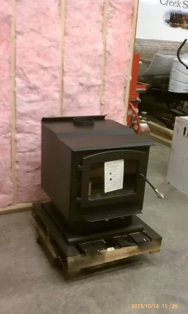

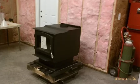

Thanks to the help here, I had an NC30 delivered to my home after purchasing from home depot. Delivery guy was an awesome driver.
I had one broken brick. The upright one that has the corner cut off right behind the latch. No big deal, probably just leave it.

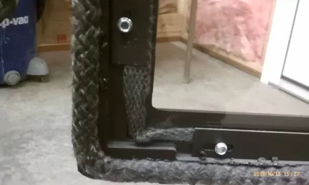

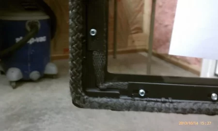

The other issue is the glass gasket. Is it supposed to be centered on the glass? Can the glass hold downs be loosened and the gasket reset? Any thoughts?
The stove was really heavy. I set it on the dolley myself with leverage as my only helper. It's not overly large but it sure seems to be built well. Love the door gasket and latch design.

You can reset it. But that is pretty much how both of mine look. Probably better to take the retainers off now and ease your mind now rather than later. Not as messy now.

As long as some of the gasket is under the glass, I wouldn't mess with it. Mine is not centered but hasn't caused a problem ever.
I'd do a dozen or so burns, get a little used to the stove, and see if you have the tell-tale evidence of air leaking there (black on the glass). If you do, contact englander and ask them how to proceed (since it's under warranty).
Would hate to tell you to adjust that gasket, then break the glass, etc, etc, if it's not necessary.

You can take a flashlight and shine it in the channel between the front of the door and the glass. If you see gasket all the way around you are good to go.

Also, my glass gasket looks identical to your pics.

I never looked at the gasket. I lit it up figuring if it leaked I'd have a big black spot showing me where I needed to look.

as for the brick behind the door latch its supposed to be cut off like that, if thats the brick you refer to as broken no worries, if you have a different one that is broken let me know and i'll replace it.
as for the glass gasket , as BB said if its seated properly with the gasket pinched between the door and the glass itself it will seal, but, as with the brick, if its not sealing or you have an issue with it let me know and i'll ship a replacement for it as well.

The broken brick is the one with the corner cut off. It's also broken but let's not worry about it now. On the glass gasket I will use the flashlight trick and even test burn it to check for leakage before I risk replacing. Neither of these things will prevent me from getting a fire going in this hoss of a stove.

tell ya what, click this link and fill it out and submit it, that way we can register the stove , in the comment box refer to the broken brick and we will get a replacement shipped out (easy peasy) if its broken and its new i would prefer to make it right by you. no big deal for me to do it.

The glass/gasket relationship is the same on my insert. Consider contacting ESW for a replacement fire brick
