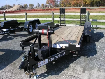

I like that. In fact, an arch like that was my "plan A", but I hadn't seen a good place to attach one on the top rails of my trailer. I like his idea of using the gate attachment pintels, which works surprisingly well. I'd have thought the arch pivot would need to be farther forward on the trailer to work very well, but I was wrong on that. The only thing I don't like about this is that it means pulling off my very heavy gate to install the arch, and then hauling without a gate, unless I'm going to swap them back and forth for each run.
I came up with this "plan B", because I lacked the foresight to think of using the gate hinge points. I think this could work fairly well. I'd be dragging more than lifting, but with the winch up high like this, it also gives me a place to tuck a large deep-cycle battery.

Maybe the best plan is to get that winch mounted up high, as shown in this photo, then consider the arch as phase 2.
I like the arch, but I think it'd be simpler for me to have a frame-mounted winch in front, and drag the logs up a ramp in the rear. If you have a landscaping style tailgate, maybe screw a piece of plywood over it for easy sliding.

Need to get moving on this. Ready to buy, now. What size winch, and why? I'm inclined to just go big, as I'm worried about duty cycle and loaded speed, if I go too small. I'd rather spend a few extra dollars for a 12,500 lb. winch, than wait an extra several minutes per log for a 4000 lb. winch, but the big'uns do come with the penalty that I could easily break something on the trailer or mount if a log snags.
Any advice folks have on battery isolators would be appreciated. The plan is to mount an extra battery (or even two) in the elevated winch mount (shown above).
