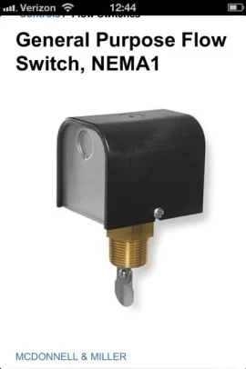

i opened the flow meter last night and pushed on the spring mecanisim with a screwdriver , the damper motor started to work . iam wondering if thats the issue
I'd say if there's a flow switch in your system that its working as designed. Sounds like your air bound. Flow switch look something like this? [Hearth.com] greenwood 100 damper motor problem
ok i googled it , my system is an open system ,how would air gotten into the system ,could a bad flow switch cause this
I don't think a bad flow switch would cause the air. It's not uncommon to get an air pocket in the system after it sits for a long period of time. The flow thru the boiler showed be silent. Where is the boiler located?
