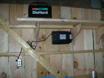

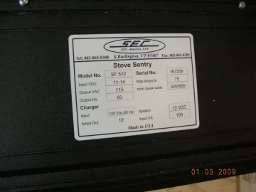

Go to the following company: http://www.secamerica.com/index.php# Order a Surefire SF 512 and install along with your Greenwood. It will run your circulator during a power outage. $3500 is a great price. If you are in the N.Dartmouth area, I know of a Greenwood 130 running problem free in its 4th season that you could go look at. I have been running a Seton 130 for one season.

  • [Hearth.com] Greenwood GW-100

I'm sure it would, I don't know for how long though, I guess it depends upon the draw of the circulator and fan, and the capacity of your battery. You'd have to do some math.
