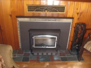

Ok, my stove top was showing a dull but red glowing top around where my ss liner is connected, I turn the ligh off in the room and could see it. So I opened the door and waited about 30 seconds to cool it off, Im in a unique situation as an insert owner because I can see the ss line about two foot above my stove because I have a fireplace grate that allows me to see about 3 inches of the ss liner and it was cherry red ( im chittin now) so I closed the door pushed the air all the way in and put a box fan blowing on high directly on the stove. Took about ten minutes but the stove started to calm. Notice the brass grate in the photo. Even today when my stove top hits 600+ degrees I freak.

Brian and all, I wonder if this wasn't a chimney fire? I've never had one. But my single was chimney, 3 ft above the stove stays close to the stove top temperature. Even when I've had the stove rippin at 700. We (my Wife ) had a runaway one day when she didn't get the ash door closed. You may recall my thread last year " The Fire dept came to my house". I just asked, she said the stove was over 750 and she didn't look at the chimney temp.

Hmm.... makes me wonder about my thermometer. I had an episode with a pegged (1000 F) stovetop coil thermometer but nothing was glowing. Stove was just pinging a lot. Quickly resolved with closing the pipe damper and opening up the stove door for a bit. Maybe try a different thermo and see if they match temps.
By the way Brian,, glad you made out OK and NICE STRIPER!
Reactions: etiger2007
Why was the flu temp so much higher than the stove temp? I keep an eye on my stove temp, but don't have a way to view the flu with my insert.
Probe thermometer. Read about double what a regular magnetic surface moubt flue thermometer reads. Took me a bit to get used to it when I put in a probe.

That is odd my stove side thermometer's were reading 900 and the stove was not glowing this morning.
