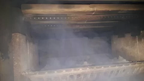

Go fire it up and smokes from underneath and behind . Demper open . Pulled out .
Door seal is good. . Did I not clean it right and f.ed something up ? Nothing stuck in pipe it got mash all around it. [emoji36] please help before I rip that thing out.

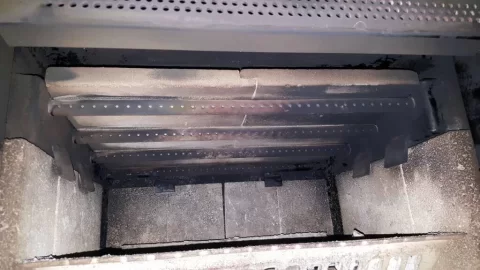

Do you have the two baffle pieces in the proper position?

Read the manual. You can pull the 2 piece baffle out without remove a tube. Hopefully you didn't break it when you brushed from above. The manual also says how to position the baffle pieces: I know you want them as far back as possible and I think they have to go as wide as possible while still overlapping of course.

So maybe I was confused what baffle is. I did remove the puzzle thing without removing these

Yes they are .in exact same spot as they did before I removed them

Can you feel cool air when you put your hand over the baffle? That means you have a downdraft.

Yes I can
Then your flue is not blocked you have a reverse draft either from negative pressure or a cold chimney.
